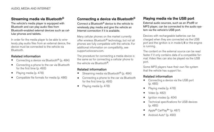

Have you followed the directions/hints from this page in your owners manual? If you don't have one you can view yours at this site. https://volvo.custhelp.com/app/manua...2019/model/S60
