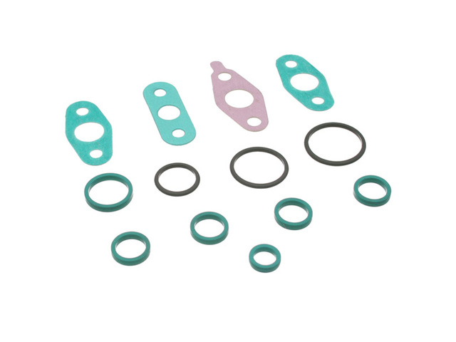

================================================== If your lamp still on and of, is and indication that you have a leak on the oil pressure system. if when you first start the car when cold, you hear lifter sounds for the first few seconds you may have a leak from the oil sump seals. To replace them you need to remove the oil pan. it happens often on Volvo's.
Attached Thumbnails Did I really kill my S60?-oil-sump-0-ring-gasket-kit.jpg
