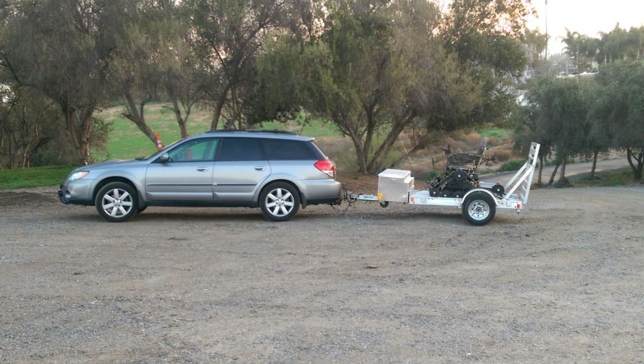

I use a wheelchair and have a Track Chair for hunting and fishing. Here are a couple of pics (I have been pulling it with my Subaru Outback which was super easy, the trailer harness just plugged into the existing connector hidden under the carpet - click and done). It's a pretty light load and I don't need brake control, so SHOULD be pretty simple, but Volvo doesn't make it easy.
