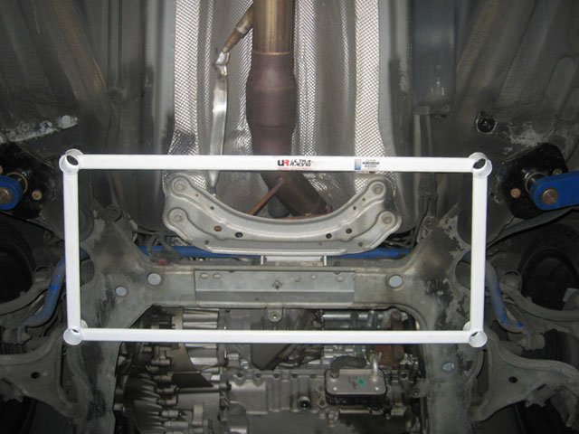

You can see my CAT on my iPd 3" downpipe in the pic below.
