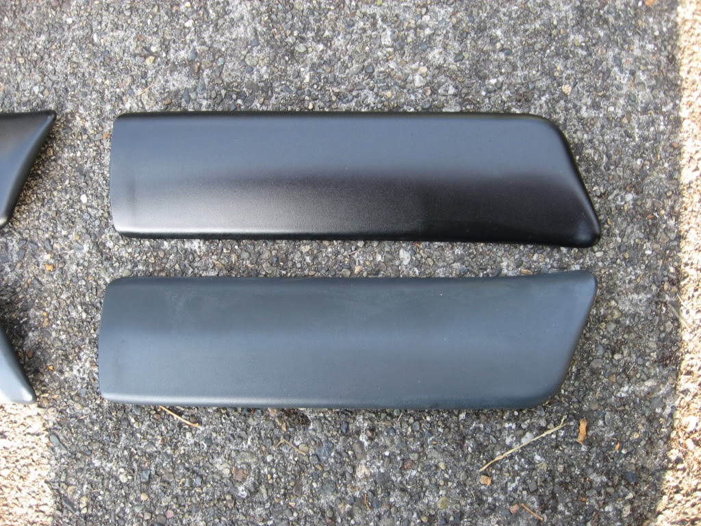

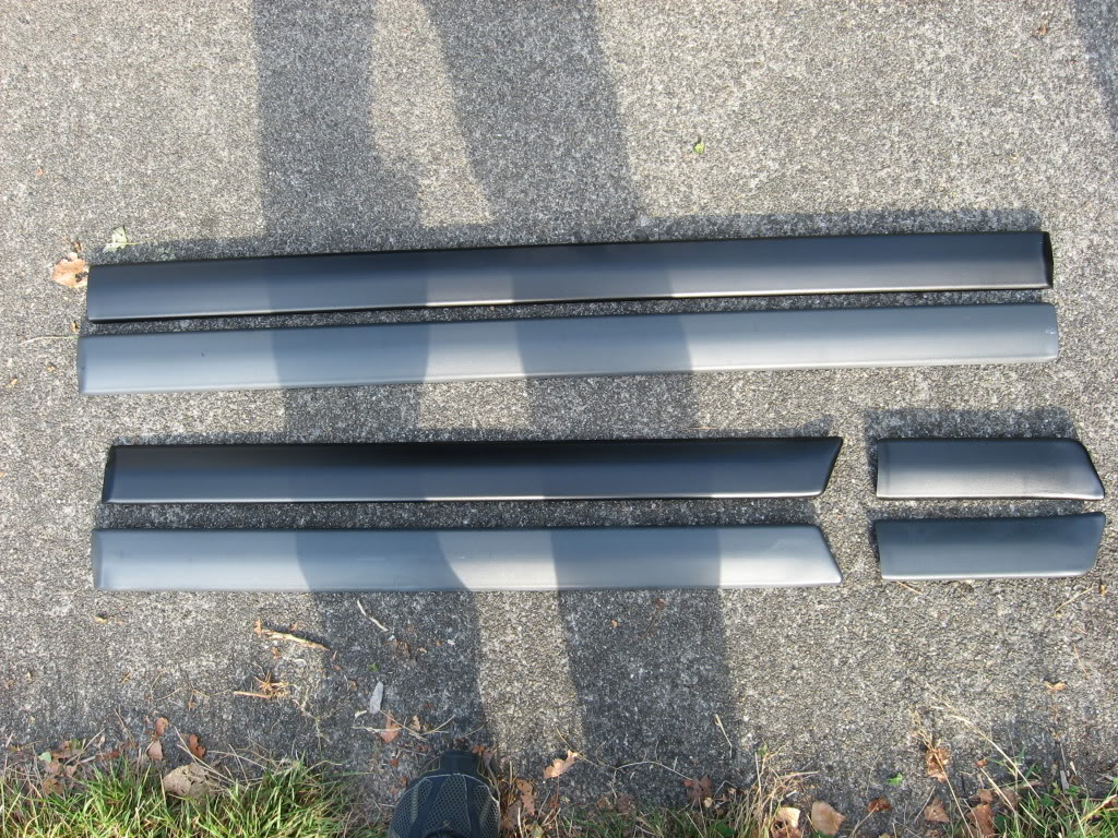

I just did this on my 854R. I used Black bumper trim spray paint. It tool a little longer cause I removed the trim from the car but the outcome is great, and won't fade like the back to black or any other dyes. Cost was in the $5 dollar range, and took a few hours to remove the trim, paint, dry, reinstall.
Here are some side by side shots of the trim before and after.

that looks nice, but how did you do the rest of the molding on the car i.e. the bumpers and the underneath parts????? I am sure you did not remove those parts of the molding did you???? looks good but 2 time consuming, go with the armour all or the 303 or the shoe dye, it will do the trick just fine

The 850's lower trim is already painted to match so I didn't have to mess with that at all.
I sure did remove the front and rear bumpers. The Rivets are a bit more time consuming but worth the effort in the end. Once I removed the bumpers I just taped off the trim and sprayed it still attached to the bumper covers. I replaced the rivets with bolts and nuts for ease of installation.
The sideskirts really aren't all that hard to remove on the S60's either. There are rivets on the ends and plastic clips along the bottom. If anybody's interested, I have the directions for removal and installation of the sideskirts.
You are right though, the dye's will do the trick just fine, but as a temporary solution. You want permanent, you gotta paint.
On a side thought, have you given any thought to painting the trim to match the car? It'll make your car look newer ('05+) and much cleaner. IMHO the black plastic trim kinda cheapens the look of the car.
