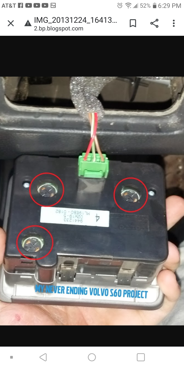

This is a better picture of what Im trying to find.I am looking for information on the wiring harness that plugs into the back of the light control switch in a 2005 s60.It looks just like what is shown and I'm fairly certain it is a 2 prong plug.Im looking to find out what this section of the harness is called or if anyone knows what the part number is.There is a short in the one in the car and the lights only work if you jiggle it violently and then immediately turn off if you dont hold the module correctly.I need to find out if the harness can be replaced or if I can splice one in from a salvage car without freaking the computer completely out.The control Module was just replaced and thats how we found out there was a short in the wiring itself.
Ignore the red circles.My issue is the green connectors wiring is shorted out and I need some info to be able to replace it or splice one in from a salvage vehicle.

Sure splice one in - light switch modules don't require software or anything - so not quite sure what you are asking. If you think you have a broken wire or bad connection, cut and splice. Have you tried replacing the incandescent light bulbs if that's the problem?
Or did the light switch module come with new bulbs?
