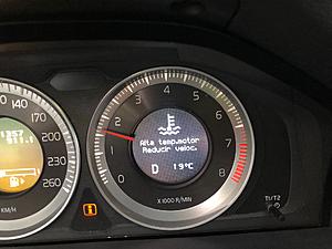

Climate system suddenly stop working and begin to give heat and humidity just like a sauna, the system shows a warning of "engine overheating, slow speed" even on cold days, and with car stopped, then when the engine stops, the motor fan stay on for a long time, around 5 minutes
on the last regular maintenance, i have asked for a climate system checking and i get an "all OK" twice
I had tried none so far, just try to use less possible the climate system
just want to know the possible cause to this and how to solve it
thanks

Uncontrolled heat and humidity is a possible sign that the heater core or connections to it are leaking. Have you checked your coolant level?

I would suggest you check the coolant level yourself. Page 312 of the US owner's manual shows the location of the expansion tank:
https://volvornt.harte-hanks.com/man...ers-Manual.pdf
Even if the coolant level is OK, there could be a problem with a control in the system. Since you are getting warning messages on the dash, the dealer or a mechanic should be able to retrieve those messages, or at least reproduce the problem you're seeing.
