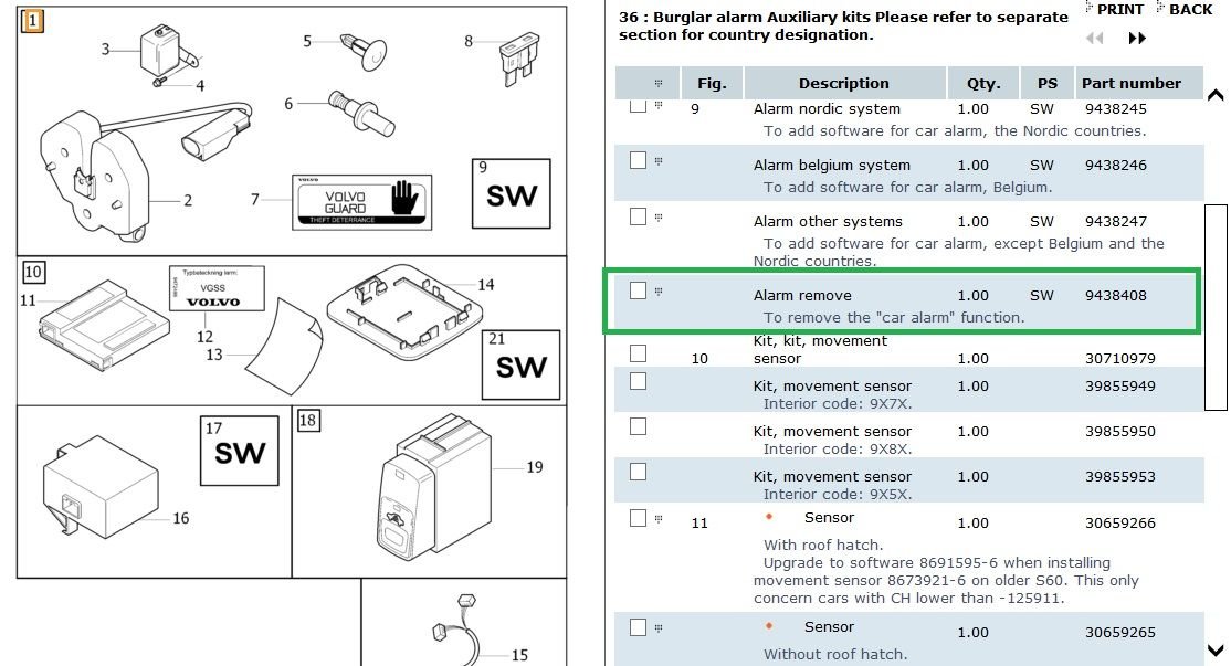

Yes, It's probably something like the "alarm remove" software below. The software is a download using a VIDA subscription and compatible Dice unit. Same as the process needed when replacing many modules in your car. The software is tailored for each car by VIN before it is installed - (just like many modules are coded to the VIN in the car.)

Thanks. That looks like what I'm after. However, I don't see prices. Do you see how much the Alarm remove package is? I'm looking at a short subscription, the cost of this Alarm remove, and the DiCE device. It's getting expensive.
Old Nov 6, 2023 | 08:25 PM
3 day subscription/$~70, software/$~30, Compatible Dice unit/$70-$500, (if you can get the clone Dice unit to work, if not VDASH might have a solution to be able to use your clone dice) .
Of course you won't know that until after you purchase a 3 day VIDA subscription and try to get your possibly non-compatible DICE unit to work. Then you have to learn how to operate the VIDA software. (there's no human help line - when I had a problem you emailed them and waited, waited, waited, for a response - hoping the solution would come BEFORE your 3 day subscription ran out!)
Unfortunately - it's cheaper to just replace the bad siren module if you don't want to deal with the message!
