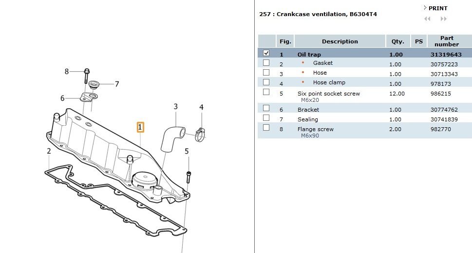

Yes - there is a problem with the PCV system - too much vacuum is in the crankcase - so it makes the squeal as the air leaks past the oil seals. If you have the 6 cylinder engine you may need to replace the oil trap - or the diaphragm in it if you can find it sold by itself.

FCP does sell just the diaphragm (for the T6 3.0L), the whole unit is $$$.
