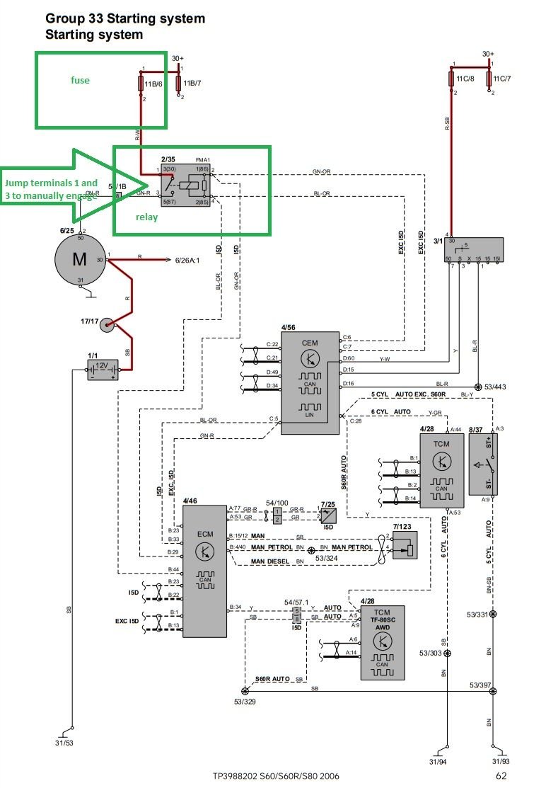

hey all im kinda stumped here... 06 S60 T5...a no start issue turn the key and the starter doesnt engage...everything else powers up dash, lights, radio ect decided to check fuses but i cant seem to find the box for the starter. I have pulled and cleaned the connections to the starter and they seem fine... Im kinda lost here ....none of the fuse boxes i can find/check doesnt have the fuse im looking for as per the wonderful WWW. What am i missing?

Fuse, relay, - looks like the ecm/cem decides when to energize the starter relay. You could try manually jumping between terminals 1 and 3 to manually energize the starter as part of you diagnostics.
A wiring diagram can be found at volvodiag.com - you can use that to figure out where components are located.
