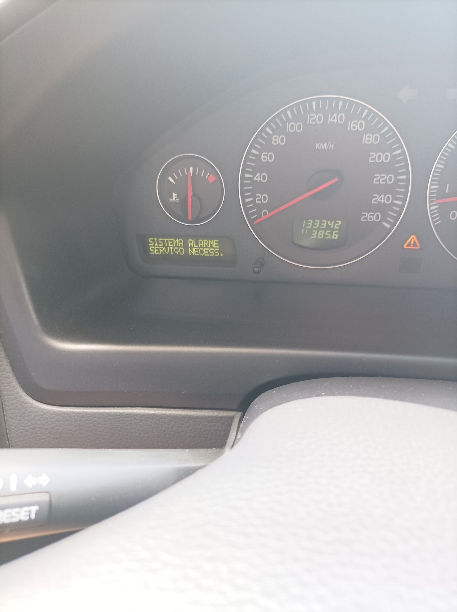

Ola,
I'm looking for updates to the volvo S60 2.0T 2003/2004.
The car displays a review message in the alarm system.
I have been informed that the software update resolves this message.
If anyone has the link or file for updates of this software of this model and year, I will be grateful to receive.
I looked for the concessionaire, which charges a fortua for upgrade.. unfortunately..
Old Nov 20, 2021 | 06:45 PM
Typically that would mean your siren module is bad. The backup battery in it goes bad after 15 - x years. You need to scan the car with a compatible scanner and see what codes are stored. You might be able to keep the code from coming back by disconnecting the siren module (under the rf fender) if you don't want to replace it.
A software update will not fix a bad siren module.
