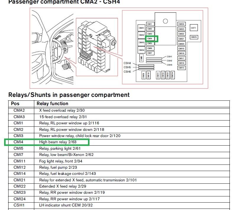

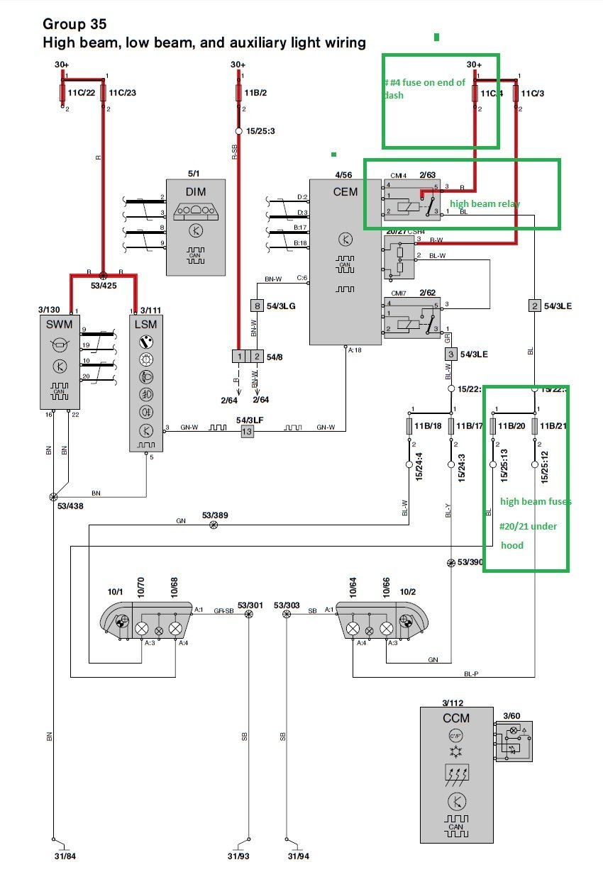

With your $5 test light do you have power at the #4 fuse on the end of the dash? (11c4) Do you have power (with high beams switched on) at fuses 21 and 20 in the fusebox under the hood? (11b20, 11b21) Could be a problem with the relay (2/63) - not easy to get to - it's in position 4 on the CEM, you could swap with any other with the same part number to test. (
