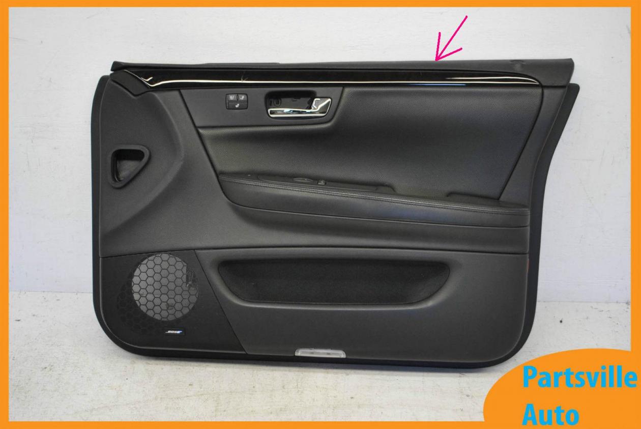

you may want to have a look at the inner horizontal window black trim. i had this trim bent and pressing against the window. i removed the door panel to get access, removed the black trim then cut off the bent portion. no more squeaks.
Attached Thumbnails  Window Blocks-2006-2011-cadillac-dts-door-panel-trim-leather-ebony-front-right-passenger-oem-221356768683.jpg
