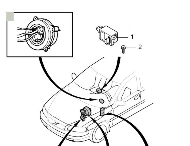

Does anyone have any idea where yaw sensor is on 2003 s60. Everything I have seen points to under the passenger side front seat under a amplifier . Its not there neither is amplifier. Thanks
Old Jul 30, 2022 | 07:36 PM
Should be under the seat/carpet on the right side. Why do you ask? An amp is only there if you have an external amp.

No it's definitely not under there. Because I took in a whole bunch of water and now the car won't start after it died
Old Jul 30, 2022 | 08:52 PM
Yaw sensor will not make the car not start - is that why you are looking for it? Vida shows it here under the right seat-

Thank you for that picture so it's actually on the seat I didn't know that. I was looking under the rug. Well somewhere on this forum I saw that it would cause the car not to start. There was about 3" of water down there from water coming in the sun roof it was driving fine the Anti skid sensor came on it's slowly lost power and now won't start. A nice man did stop with the code reader and he said that it wasn't coming up with the code A nice man did stop with the code reader and he said that it wasn't coming up with the code But it wasn't Starting so I don't know how he would be able to see that. I live in the middle of nowhere so of course there's not a Volvo dealer or even really a mechanic nearby.
