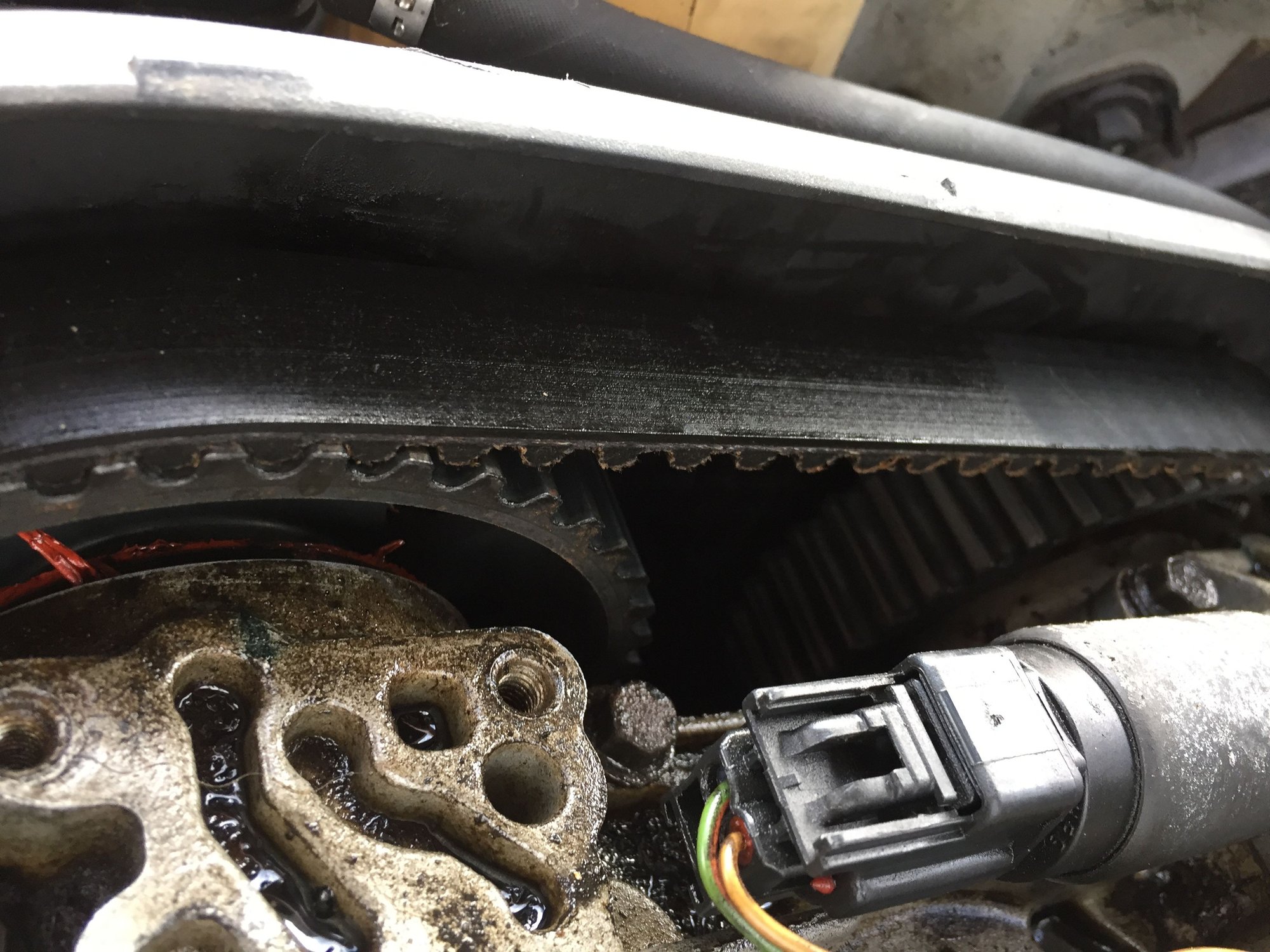

Hmmm, if your sure you have spark, it should fire with the starting fluid. You heard the fuel pump so that is a good sign. I would suggest charging the battery a bit, then trying the starting fluid again 2-3 more times (waiting a minute or two between tries to avoid a buildup of too many fumes). Take the plastic intake hose off the air filter box and spray the staring fluid into that. If it still does not fire, Re check the timing just to be sure.....I attached a picture of the timing marks in the proper position. If all checks good, and still no start, then the Crank position sensor or the cam position sensor may be bad. Both can prevent starting.

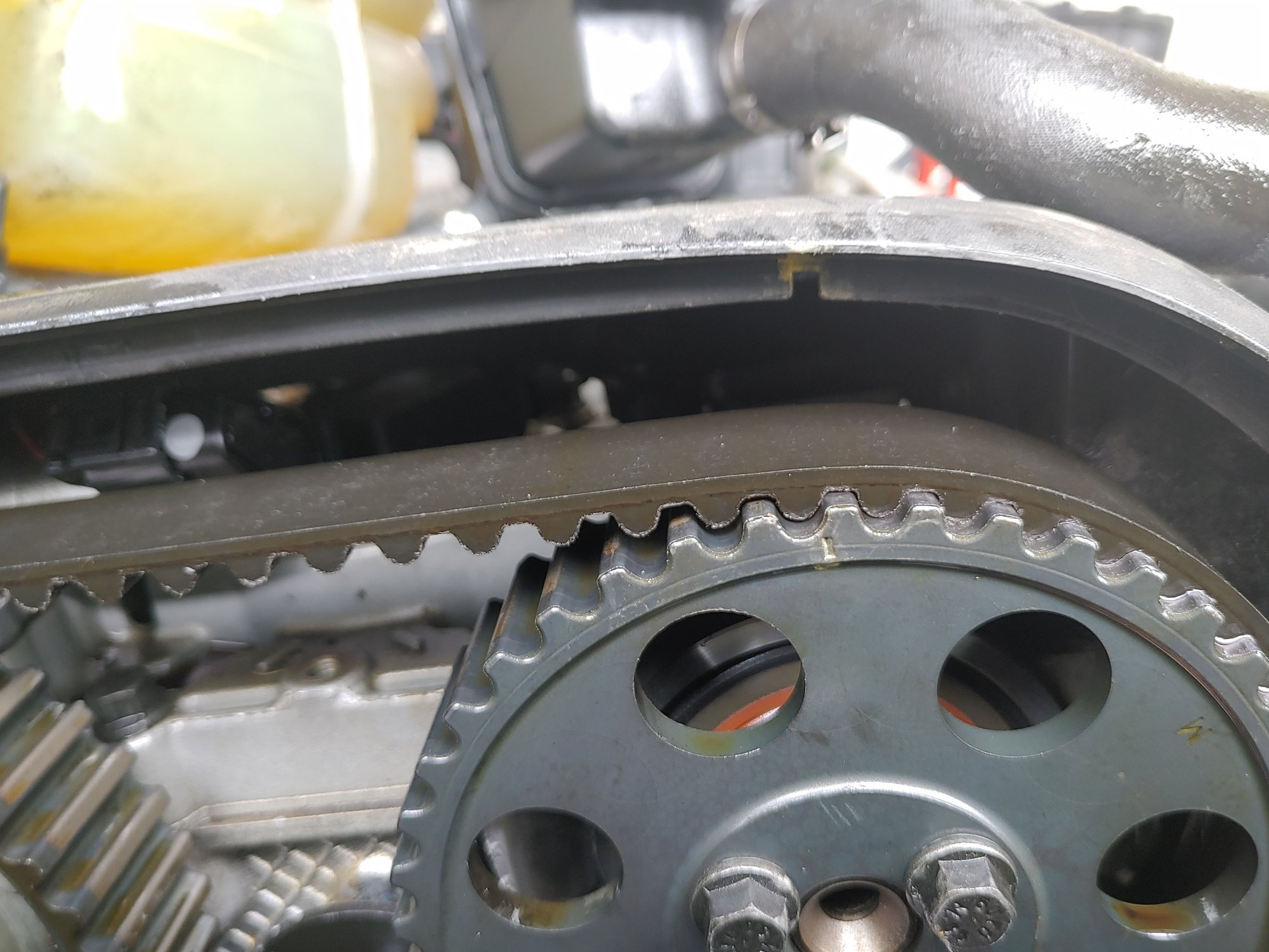

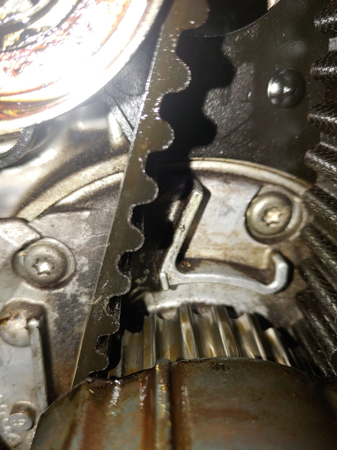

Old Feb 22, 2021 | 09:50 AM
  #19
ganjafarmer's Avatar
Joined: Feb 2021
Posts: 20
Old Feb 22, 2021 | 09:52 AM
  #20
Joined: Feb 2021
Posts: 20
How do those timing marks look to you? They look good to me, but I'm no expert.
