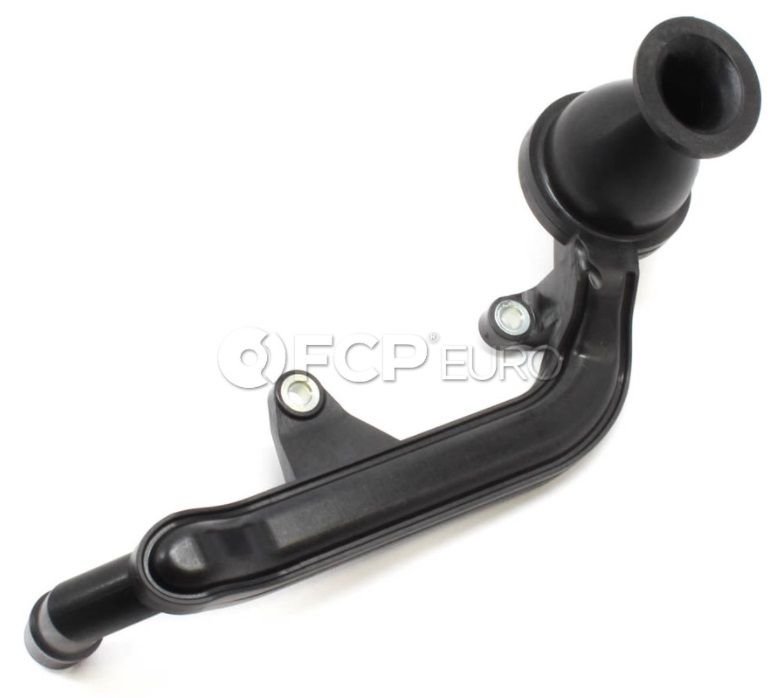

I have solved that issue with several Volvos that have had lots of sludge in the oil pans. The solution is a new style oil pickup tube. (the old style is partially clogged) Usually discovered after replacing the bad (smoking) turbo! (since the car was towed in smoking badly and the engine was only run to verify oil getting into the exhaust)
It's not your oil pump.
You might want to make sure the pcv system, especially the oil separator box is clear - normally the passage draining back into the oil pan gets clogged (pan has to be off to clean it) and if the system gets clogged enough will blow out the cam seals, making a mess.
https://www.fcpeuro.com/products/vol...Lw_wcB#fitment

Yes, the first time my shop came across the low oil pressure at weird times problem, (after replacing a bad oil burning turbo with bad bushings in it) we cleaned everything including the pick up tube as best as possible. Low oil pressure at weird times still occurred after reassembly. Pulled oil pan again - orings were in the correct positions, we replaced oil pick tube with the new style tube and had no more oil warning light at weird times. From then on whenever solving that problem a new pickup tube was installed and did not have any more recurring oil light problems on those cars.

As before - It's not your oil pump. I have never replaced a bad oil pump in any engine (no "american" (gm/ford/crys) worked on) since 1972. And never in a Volvo at my specialty shop since 1980. So replace it if you wish, then find the real problem. Sorry for the attitude just trying the keep you from going down the wrong path.
You either have a suction leak on the orings or a partially clogged tube or both..
