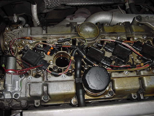

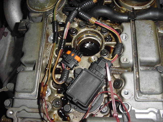

My wife was about 150 miles from home and pulled off to get a soda. When she started the car and put it in gear, it started stumbling and misfiring under moderate acceleration. It idled fine and if she punched it, it ran smooth. The next day, I got in it and it ran the same way. I pulled the codes and got P0305, P0135 (twice), P1618, and P0705. I had never pulled the codes before so I'm assuming the 705 was from the time the car got stuck in winter mode. Shoving the shifter through its full range back and forth had solved that problem. I can't figure out what the 1618 is, but occasionally the ABS light comes on. Anyway, I pulled the cover on the coils to check them and the spark plugs. There was oil all over everything. I pulled each coil and rubber boot and #2, 4, and 5 had oil in the spark plug cavity. #2 was nearly full to the top of the hole! I have pics below. I soaked up all the oil and put it all back together. I fired it up and it still gave me the 0305 code. I thought about waiting until dark to see if there was sparking from cracked insulation but decided to swap the #4 and #5 coils. I figured that I would get a 0304 code if it was a bad coil. I started it up and it ran perfectly. No codes other than the O2 sensor code. I hate when something fixes itself but we'll wait and see. My question is: where is the oil coming from and how can a plug not be grounded out when completely submerged in oil?

That valve cover needs to be resealed cause it has o-rings around the spark plug wells. If ur not familiar with volvo, when u look at the valve cover it doesn't look normal! cause it's not, it's a volvo. It has almost 35 bolts in it and it hold down your cams.
I would take this to somebody who has done this before cause it's not all that simple. Pay a pro if u have to cause you have to redo the timing belt and it's tricky on that car, a lot trickier than normal. The valve covers not even a gasket, there's 5 o-rings for extra measure around the spark plug wells and the rest of the gasket is a very special silicone only made by Volvo. U also have to be extremely careful not to use too much of the silicone cause u could clog the oil ports that oil your cams. If u do that that Ur gonna have major issues.
Oil in those plug wells will make that car run like poop. Do the repair and get new spark plugs, and hopefully the coils aren't fried. I would clean them really good with brake clean and use dielectric grease when reinstalling then.
Also At that mileage replacing the o2 sensor is a good idea for all sorts of reasons. It could be helping the car misfire.

Who did the last oil change? To answer your question, oil dosent conduct electricity. The wet plug was causing the misfire. Identify and eliminate source of oil leak.

That is a lot of oil in those oil wells. My guess is that the previous owner knew that was happening and that helped them decide to give the car up.
I have never taken a valve cover off but I don't think it's to hard if you are mechanically inclined. I'm not even sure you would have to take the timing belt off to remove that cover. Someone please let me/us know. If it has those seals on each splug well, that helps keep oil out of them, I'm sure they need to be replaced. Also, you may have a clogged PCV.

Update 8 days later. Yesterday I got another P0305. Since I had swapped coils, I didn't think the coil was the problem, which left either the wiring harness or the plug. I had pulled the plug last week and didn't really pay attention to the fact that it didn't have the electrode attached to the side of it. I had seen boat motor plugs similar to this and figured it just had weird plugs. I never pulled any of the other plugs. Yesterday, I figured I would swap plugs around (I won't spend $ unless I have to!) and realized they were just regular ol' plugs. Boy, did I feel stupid! $3.50 later, no code. I just hope when the electrode fell off, it didn't mess anything up.

Oh, by the way, I pulled the boot on the #2 well, which was full of oil last week, and it was dry. Who knows how long it took to fill up.
