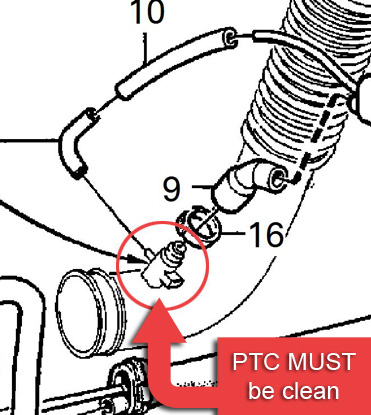

PTC ..... In the intake tube connected to the PCV black box by the vacuum lines. It's where the crankcase vapors get sucked into the intake ahead of the turbo to be burned.
