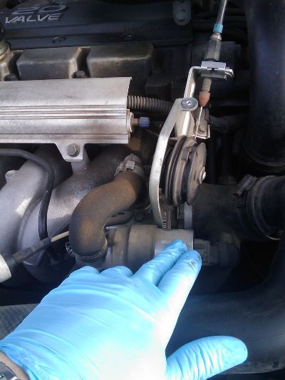

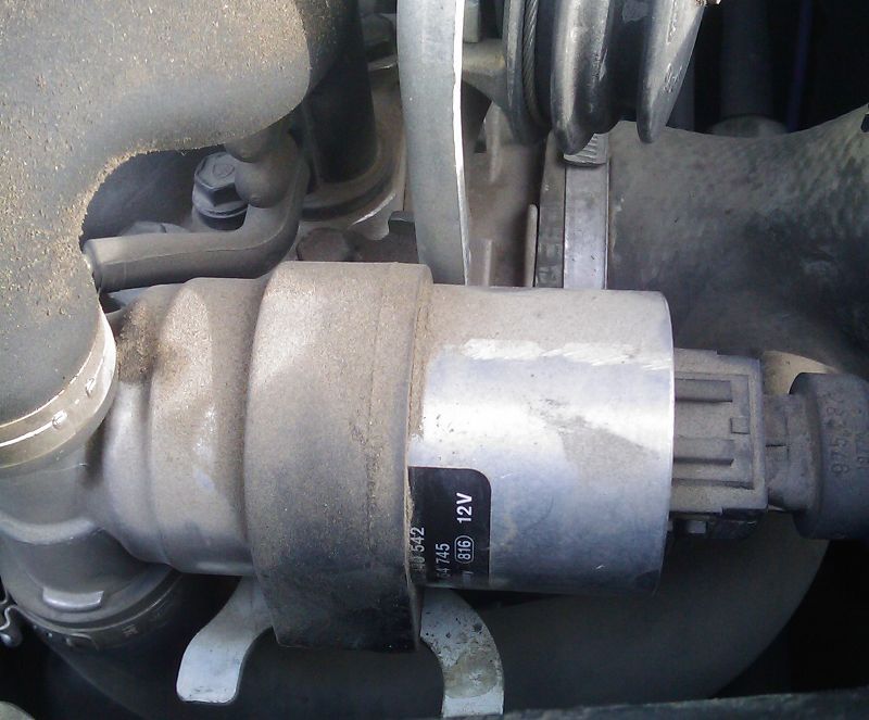

ok so I looked at the fuel pump relay. (its the relay with 103 on top right?) nothing is visibly blown or scorched and it does not have the o-zone smell. what am I looking for with this thing is it possible to test with a DMM? Also I saw a post on another forum about the coolant temp sensor going out and people would have problems starting in the cold, the telltale sign was that the fan was running when the key was in the "on" position. I went out and tried to start the car which didn't work, did its usual dying thing and the fan did not stay on when i left the key on. but there was something buzzing, I tracked it down but I don't know what it is or if it is supposed to buzz when the engine is not running. I'm attaching a couple of pictures, one for frame of reference with my fingers on the motor-like device, and one that is a close up of the 'mystery thing'

I think your mystery part is an idle control valve/motor. When I turn my 960 on, I hear that thing humming to.

The idle motor humming is normal. Pull the relay again and pull the outer cover off and check for cracked solder joints. If you have a solder iron and solder laying around resolder the joints and check the car again.
