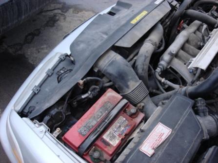

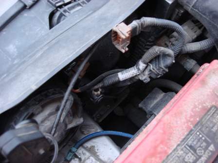

disconnected wiring harness in the front of the engine compartment. what does it go to? headlight wiper i hope?????? lol

Yes those are for the headlight wipers.
Not sure about the other question though.
