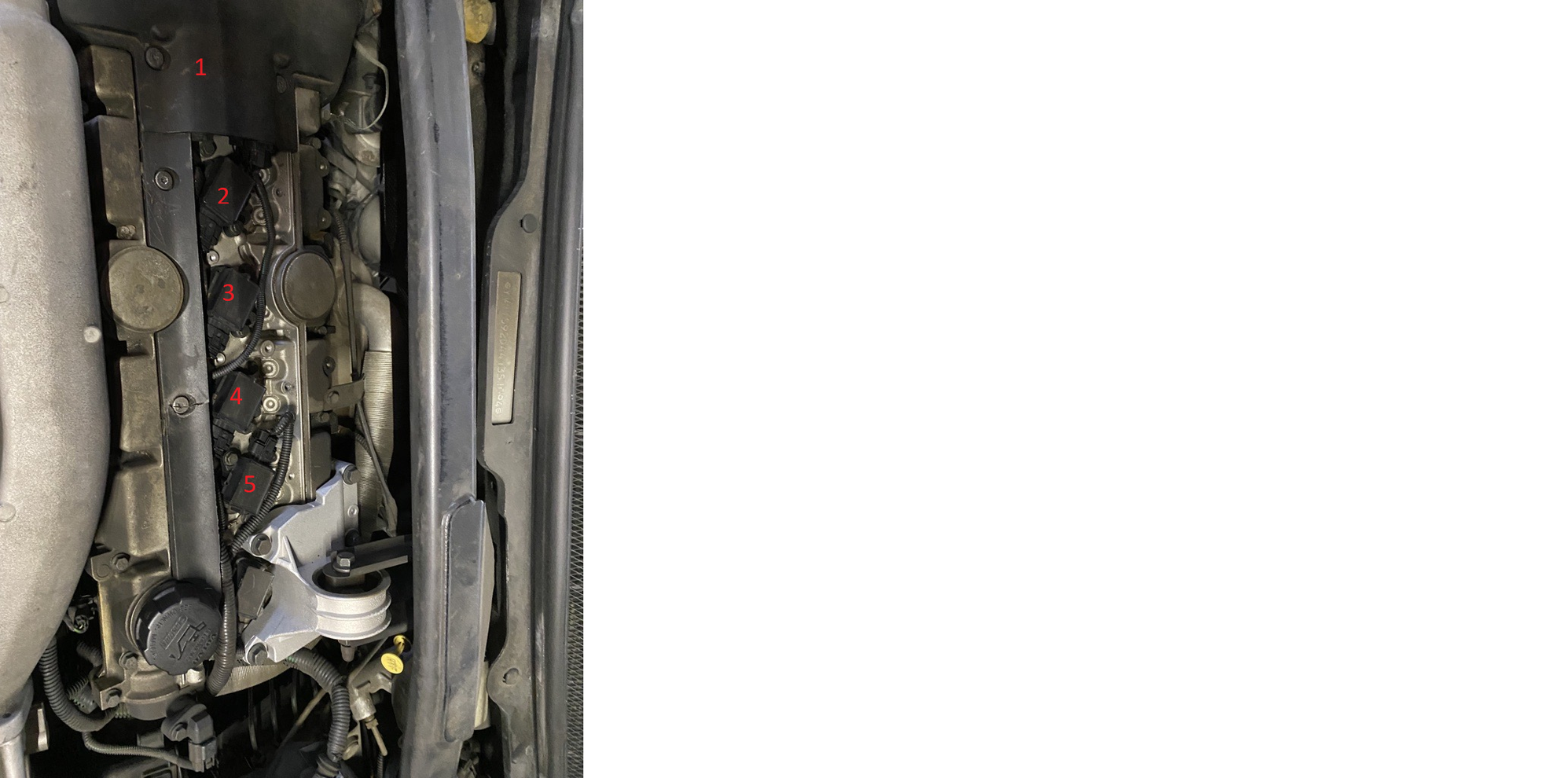

Hi Hoonk, Happy new year! thanks so much for detail information, now i understood cylinder order is just physical location, see the picture i attach here, after i switch 2 spark plug and coil to 3(the same, 3 to 2), swap 4 and 5, after driving several miles, the testing still shows the same message, P0305#11, Cylinder 5 Misfire Detected. look like it is not plug and coil problem.
Hi Hoonk,
did i mark cylinder order correctly? today the check engine light is on again, i test it, it is still showing that cylinder 5 misfire detected, actually i have swapped #5 and #4 last time. during testing, i did another thing, i run diagnosis, then error code disappear, do you have any clue? thanks.
Old Jan 6, 2024 | 03:46 PM
Posts: 9,601
Likes: 540
some codes are averaging or accumulating faults so if you scan / clear a code it may take a few miles to reset. There are 3 things that can cause a misfire a) fuel trim (rich/lean mix) b) weak spark (plug/coil/coil harness) c) compression. When it comes to compression, particularly if you have two adjacent cylinders reported, I'd do some basic tests for a possible head gasket issue (compression, check oil/water etc). For fuel trim, lots of things can contribute - intake air /exhaust leaks etc, wonky ECT or other sensors, vacuum lines/intake air tubing. Also dont rule out fuel pressure, fuel quality and injectors. For spark, you have plugs, coils and the harness/connector to the plugs Did you notice any discolor on the plugs? Are they the correct type and properly gapped? When in doubt, I'd install genuine Volvo - they come pregapped and are correct for the car.
So to Hoonk's point, you need to be systematic about your diagnostics - swapping coils is a way to determine if the coil is bad (rarely does more than one fail at any given time) and you can also inspect the plugs for color and the harness/connectors to make sure they are still good and not cracked. After that you may want to do the compression test, then do some testing for the fuel mix = ie look for air/exhaust leaks, check the coolant temp sensor's resistance etc. Lots can be done without guessing at parts to replace. You may also want to see about collecting some run time data via a full featured OBD 2 scanner to see what's going on with fuel delivery etc.
