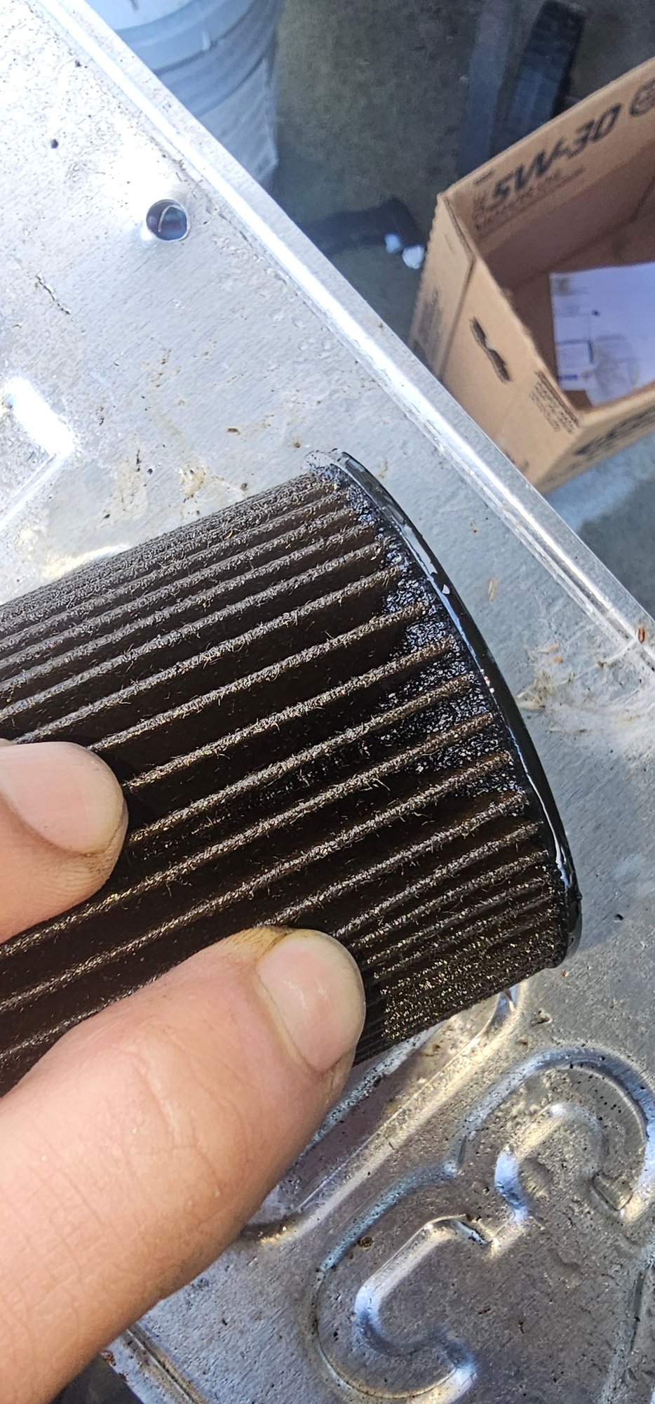

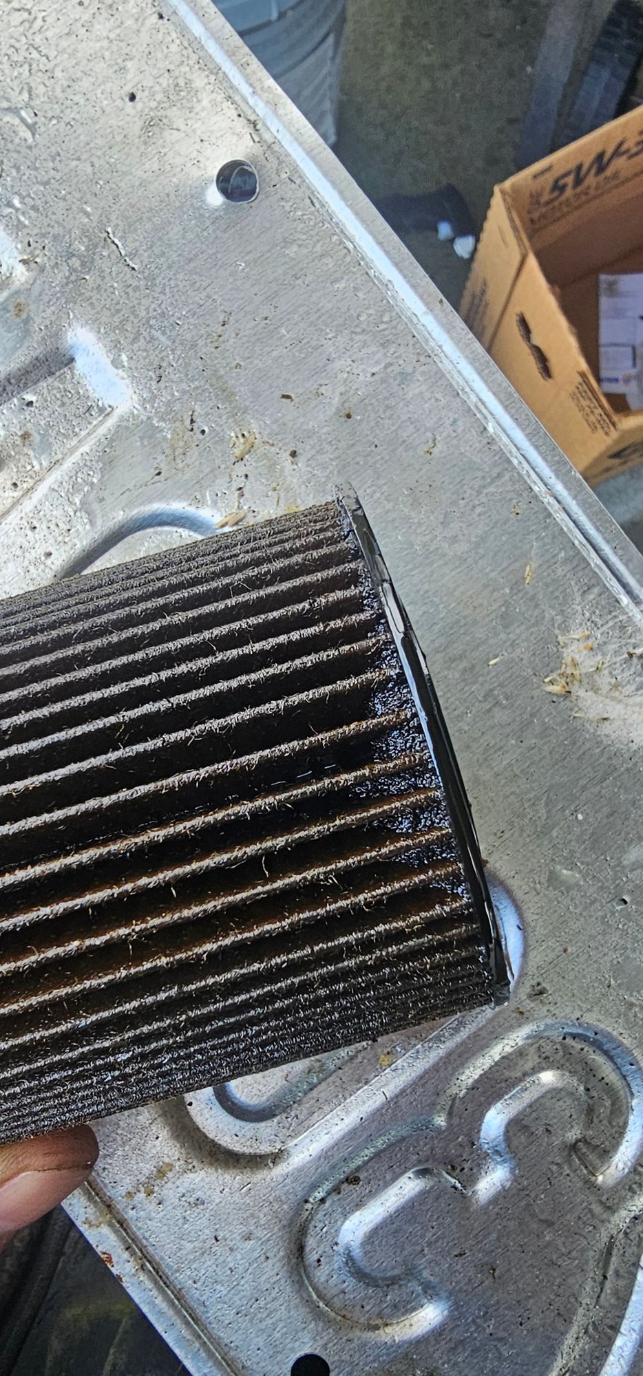

First thing I do with any new car is new fluids and filters. Well, the engine oil was a fight. I was hanging, literally, my whole body of the ground, off of a 3 foot, half inch drive breaker bar on the drain plug, and it wouldn't move. Yes, I triple checked I was going the right way. Ok, well let's at least change the filter until I can get a vacuum pump. Filter was full of carbon and sludge. Clean out the filter housing, new filter and gasket and drove the car about 500 miles waiting for the pump, and I decided to get another new filter, because why not. I was half planning on just keeping the filter I put in in it because, why not it's only got a few hundred miles on it, the oil is supposed to still be good(NOT!)I didn't look at the date on the window sticker. It turned out to be a good thing. I believe the old filter was so plugged, it was just bypassing, as the new filter was just as full as there was more sediment, about a half tablespoon worth, in the filter housing.
(Pics of the filter with ~500 miles)
The vacuum pump struggled to pump the hot oil, it was like chunky black potato soup. New full synthetic with some sea foam, and new filter and o ring. I will replace the filter again in about a thousand miles and check it. The oil on the dipstick now looks pretty clean.

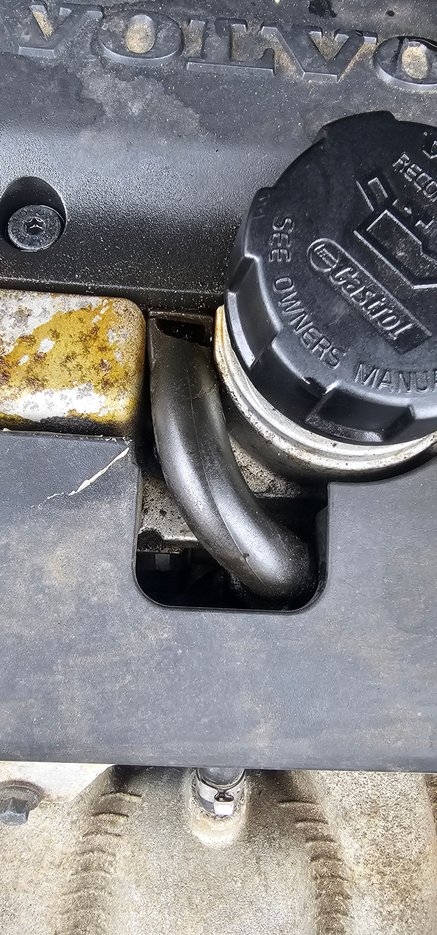

There's a plastic pipe that runs under a plastic cover up to by the oil cap that's broken. I'm not sure what it is
