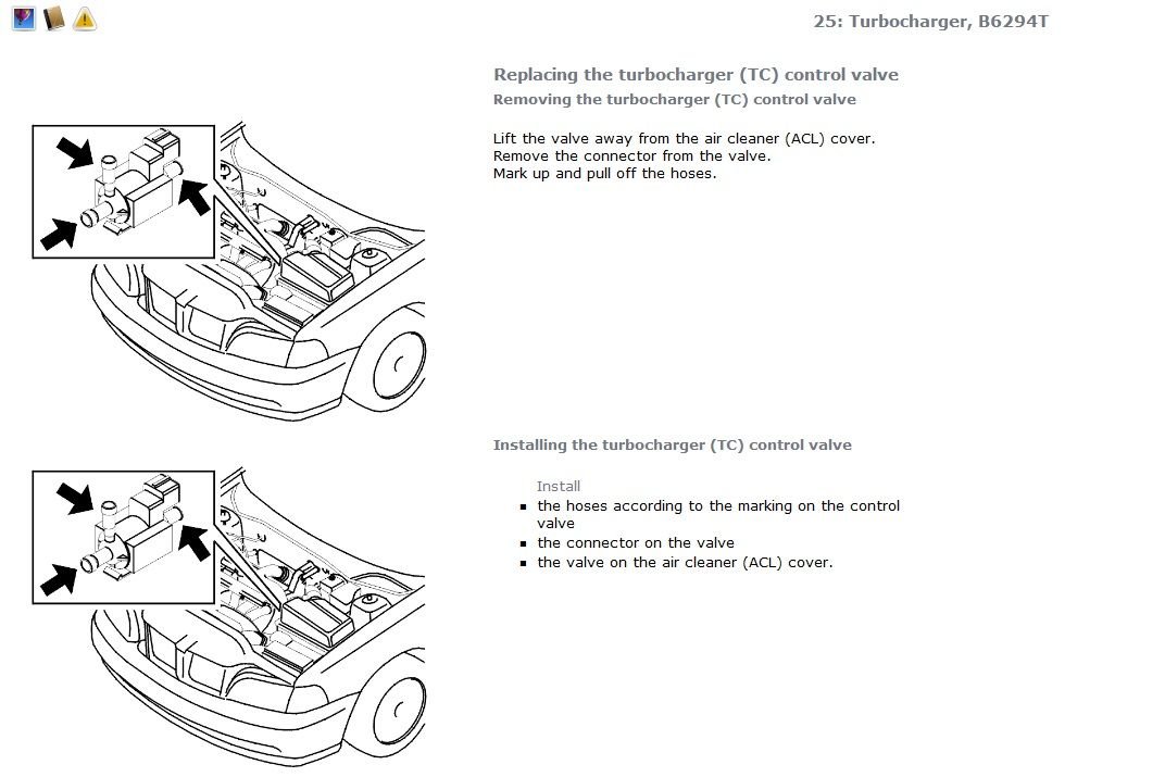

Hy guys i have an issue with tcv (turbo control valve) but i have no idea where is located, also if the tcv need to be change is there any reprogramming involved?

It is located on the left side of the air box if you are facing the car. It will have hoses going to the turbo.

It's Plug and play. What is your "issue"?
