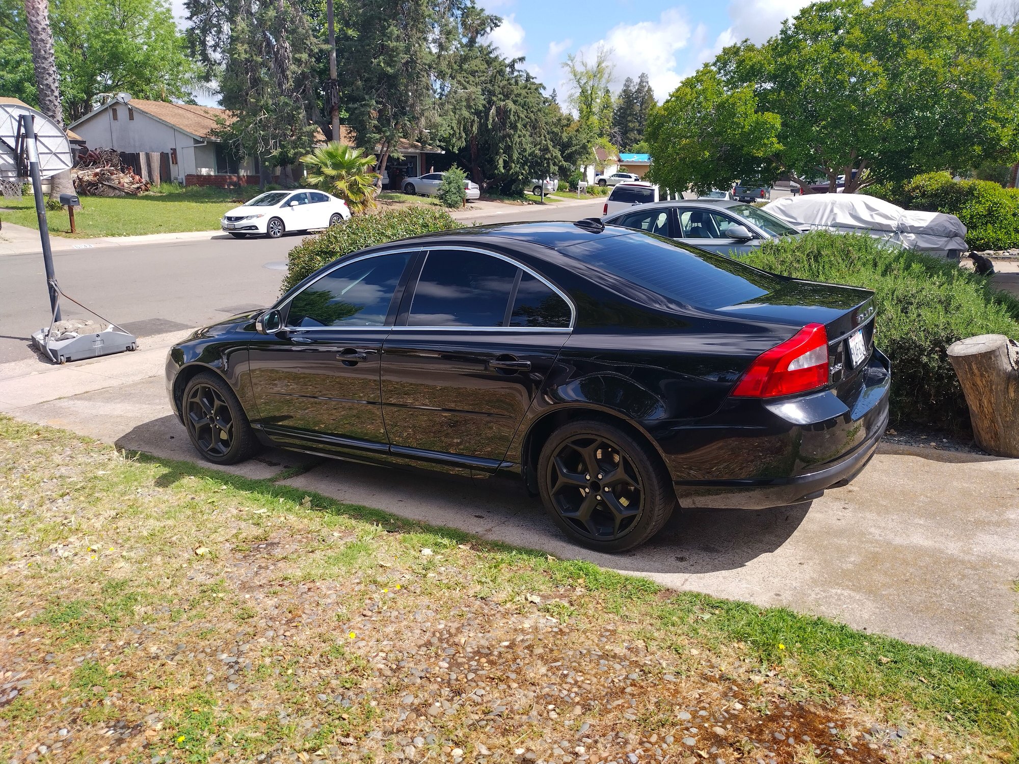

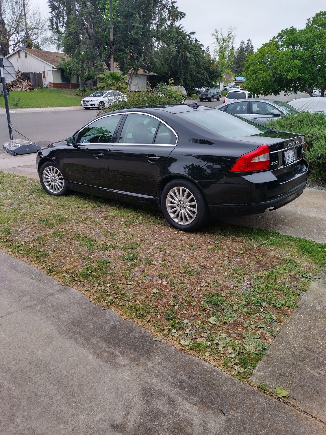

Got the wheels and cleaned them up. Quick swap with no rubbing, perfect fit. Now I just need to get new tires
Before tint and wheels
After tint and wheel swap
