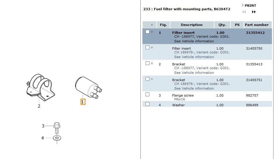

Old Aug 22, 2022 | 10:37 AM
Originally Posted by MJGS80t6AWD
Can anyone tell me where the fuel filter would be on my 2010 S80 T6 AWD? Any help would be appreciated
Vida does not show where it is - i imagine in the left rear of the car - here's some part numbers, 2 different depending on VIN.
