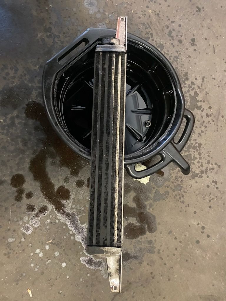

Hi!
I have a 1999 Volvo s80 with 2.9l engine (no turbo) and it seems like that I have an extra radiator that is leaking transmission fluid. The leaking radiator is in front of the engine coolant radiator at the bottom and is much smaller. I have attached a picture of it. It would be much appreciated if someone could help me with finding a replacement part. I have looked but there is no mention of that part on any site.
I attached a picture of the part.

Best I can tell, the OEM part number is 864960072 which is listing as a discontinued part. There are some after market brands for transmission coolers but may not be the exact same shape and size. Sites like Rock Auto list replacements but they look different from the OEM pic.
