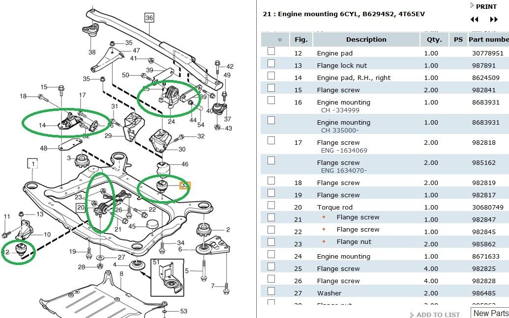

I'll check for repair videos, but any idea on whether someone can do the upper engine mount work with moderate skills and tools?

#14 front (of engine) down low on the subframe right side - they sag/tear and transfer engine vibration to the subframe. Sold hundred and hundreds of those, fixed many complaints. #12 - it's a hydraulic mount, fluid leaks out, can split in two and once again transfers vibration once sagged (is that a word?) #33 - hydraulic also - and never sold one - they don't seem to fail (but hey the cars 2x years old now, many vendors offer them in mount kits, DIYers buy them and complain how hard they are to install!) #20 a lower torque mount bolted to the trans, keeps engine from twisting too much - yes they wear but really no big deal if they are.
And #24 - the upper torque mount - the one everyone likes to sell because - they break, very visible, easy to get to and for a garage - it's profit. Many cars come in with the upper torque mount torn. I would sell them if the customer had a related complaint, (the metal bracket can "clang" sometimes) but not just because I saw it torn (because they were all torn and did not cause a problem!)
To answer your question - 24 the top torque mount, 14 the front (of engine) mount, and 20 the lower torque mounts are easy to replace. #12 have to jack engine up and/or lower subframe, (can be a pia) and don't even try to replace #33 unless it's shredded.

As I mentioned - many cars came in with a torn upper mount (and left without me selling them a new one) because if there was not a complaint I would just note it was torn. Does not really cause a problem worth spending money on in most cases.
