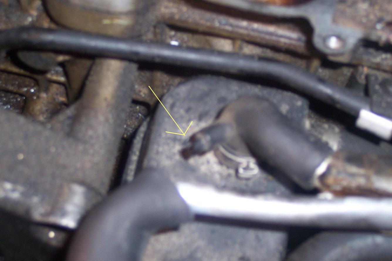

Ok, I got the intake off. What a pain in the *** for this noob.
Now, I found out I did it the hardway and unbolted the throttle body (i believe thats what it is) from the manifold. I could have just unplugged it. Anywho.
While taking the manifold off, I broke the small plastic tube that is part of the PCV system. My question, how can I replace this? I have shown a pic of my bull in the china shop job.
Also, I read on another thread to gently clean the throttle body while I have it out. Good suggestion?
Kevmcrae-
Oil trap? I am a noob and am only doing the PCV system unless there is something I am missing that I did not read on Vadis. But, thanks for the tips on the intake. I will do what you recommended to keep them clean.
Here are the pics and researching oil trap now.

The second pic shows the tube I broke better. FYI.

The vent box is what the hoses attach to by where you broke the one pipe. If you can get the one side out of the rubber part use a small part of the broken hose then use a rubber vacuum line to joint the rest.

I am not following you, sorry.
The part that broke off is at the vent box. You want me to pull that part out then just connect a rubber hose to it?
Dont I need to use a plastic hose for some reason? If I use a rubber hose, will it work the same?
I want to make sure I understand the correct fix.
Also, should I just take out the oil trap and clean it like I was told above? Is that recommended?

Yes it is reccomended to remove it and clean it. But it is a pain to get it out. I always replace them and break the old one out and cut a slot in the bracket so I can get the screw out.
You will need to use a small piece of the plastic hose to go into the rubber elbow. Not sure a rubber hose will stay on the elbow. Or if it does it will be to big to fit tight on the plastic hose on the other side.

Ok, so how much is an oil trap? Cause breaking it out sounds better and then jimmying it to fit.
But, as far as the small plastic tube, its all broken and cracked. Can I get a new one at Volvo?
Learning on the fly here............

They will sell you the entire larger pipe with the smaller one.

By the way, the rest of the plastic hose is cracked.

Any ballpark price on what they larger pipe with the smaller one?

probably better off getting vent box with larger tube, smaller tube and then going from there correct?

I would try to get one or fab something that will work.

If you can just replace the box and hoses. Sorry not sure on price though.

$193 dollars from Volvo for the little tube. Unreal.
So, I guess I get to fab it. Trying to figure out the best way.
If it is just air that flows through it, do i need to seal it at both ends so its air tight?
I believe I can reuse part of the tube and get a rubber tube to fit on to the elbow. I will let you guys now about my never ending blog with my journey here.
