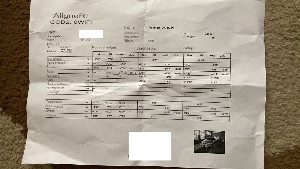

Question S80 classic after wheel alignment car pulls right
Hello,
My repairman just finished a "Space SPTD 2 WIFI CCD" wheel alignment on my S80 classic (2002).
But car definitely pulls right.
I attach the wheel aligment values:
alignment
Maybe there is some problem with the values?
I already replaced: Wishbone arms, Shock absorber (front, back), Strut mount (front back), and I have brand new tyres. So I think It may a setting issue.
