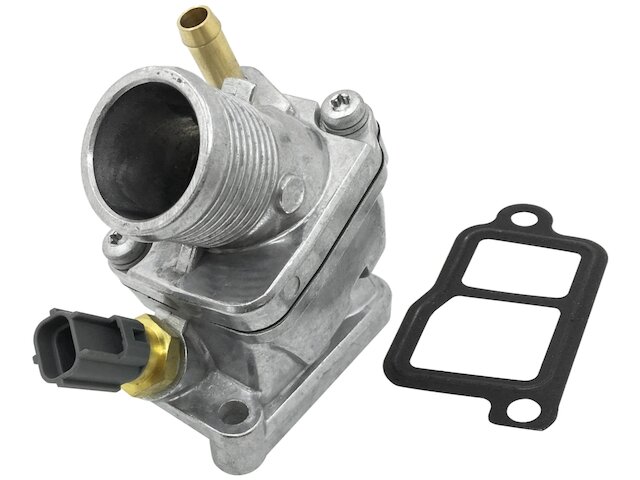

Got a check engine light code that the thermostat isn't reaching correct temperature. I'm trying to get to the thermostat but can't get the torx bit to fit on the bolts due to the power steering pump. Is there a special tool? Does the power steering pump have to be moved first?

Old Jan 16, 2021 | 05:44 PM
If it looks like this, there is not a gasket under that top cover and the unit is sold as pictured. Yea, frustrating.
