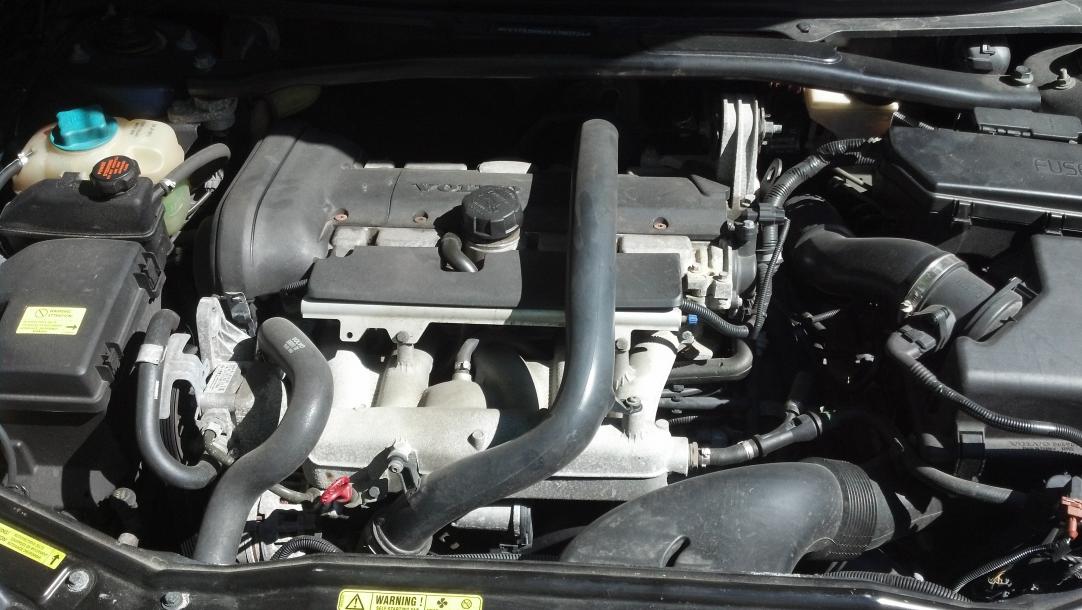

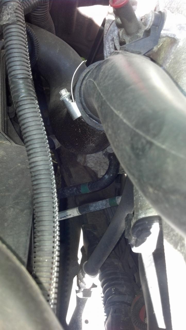

I have a 2004 s80 with 93,000 miles and no timing belt change to my knowledge. The car has had turbo issues and turbo has recently been replaced. Recently it started making a clicking noise upon acceleration that increases as pedal is depressed. It sounds like the wheel of fortune wheel's continuous clacking. I looked under the hood and noticed my oil was low, and seemed to be coming out from underneath a clamp on the (turbo) tube(?). I attached pics. Are these related and is it indeed my timing belt? Also fyi, first pic just shows it is the tube coming over the center of the engine which i believe is turbo, second pic shows close up of oil on the tube below the clamp.
I can't say what the clicking would be without some good video, but the presence of oil in that intake tube is very common and doesn't necessarily mean the turbo is bad. A phenomenon known as intake reversion, as well as excessive crankcase vapor pressures are more likely the cause for the oily intake. Keep that oil topped up, and changed regularly!

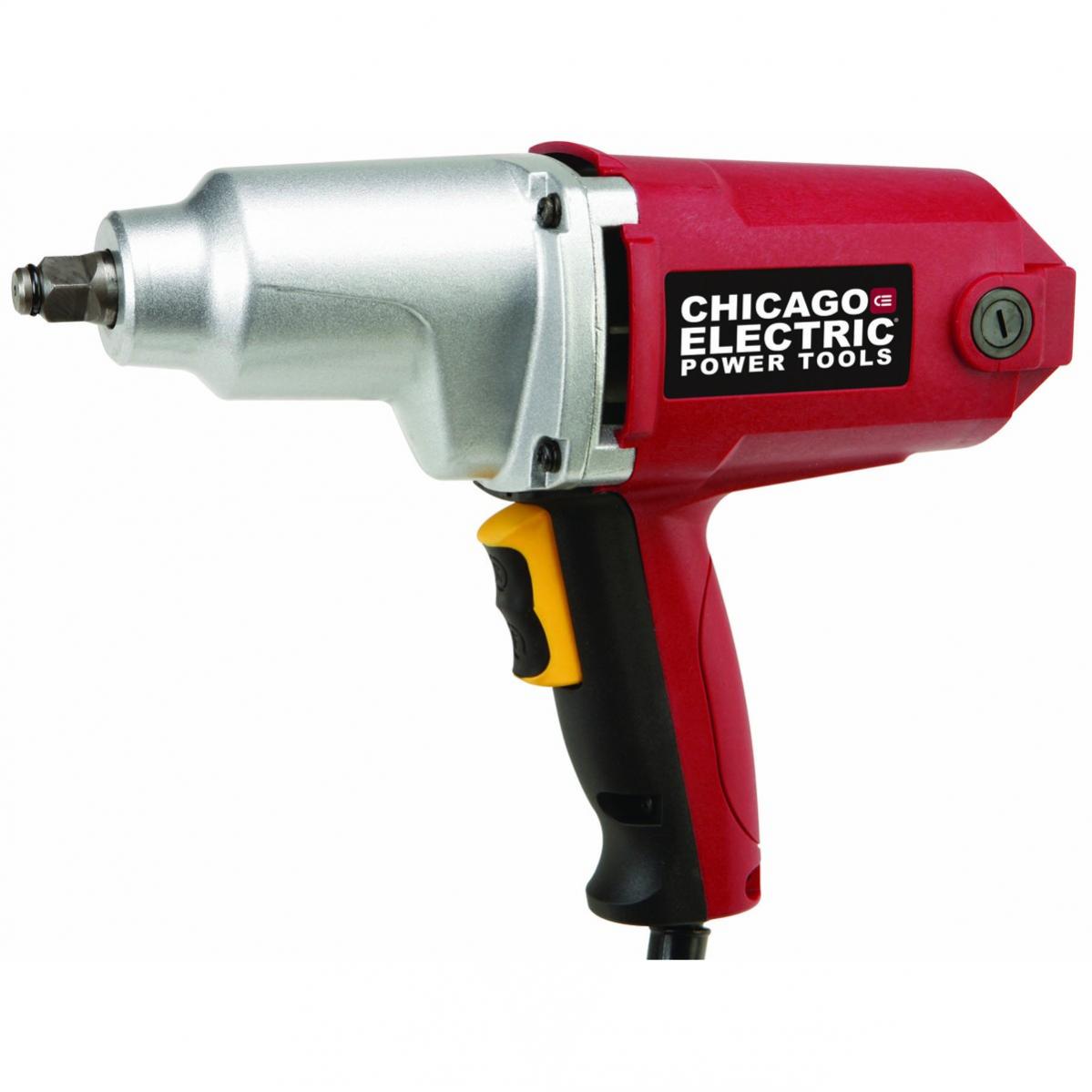

I HIGHLY recommend having a decent impact wrench for this job. I made my own makeshift pulley lock just to be safe, but I bought my first impact wrench for this job and I LOVE it. I can't believe I never bought one before. I got the 1/2" Chicago Electric from Harbor Freight. It worked great. On sale right now for 50 bucks.
