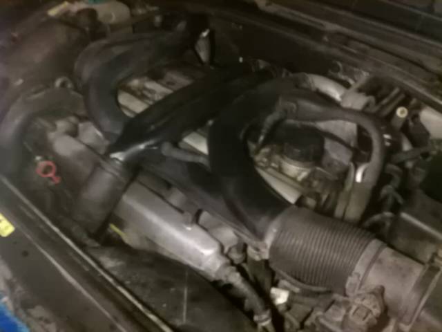

And now the plot thickens...
Today after work I decided to give it another once over. I checked every connection/sensor I could under the hood for any moisture, and found absolutely nothing. Great...
First attempt at starting: 3x 15-20 seconds without a thing. No function on my Tach, trip meter, "Brake failure, Stop Immediately" message again, and just about every light on the dash illuminated. Code reader would not give me anything, just ""?" codes found". These last 3 attempts drained the battery pretty good, I could hear it starting to weaken.
Now, here comes the good part...
One thing that I, being the type to frequently leave my headlights on for extended periods of non-use, do know how to do is charge the battery! So... I set my nifty little charging station to 40Amps and let it go for a good half hour. It was down to about 6Amp charge rate by then, so I took it off and decided to see if charging the battery to full had changed anything.
What I found, to me, is completely inexplicable;
Everything works. The tach, the trip meters, everything. The car starts. The "brake Failure" message that I hate so much is gone. My code reader works again. P0134, Bank1 o2 sensor, is the only code I'm reading.
I also have a message in my info center about the airbag, and service transmission, however no codes are displaying on the scanner for those (should I be immediately concerned?)
The idle is a bit rough, but that could be explained by a faulty MAF or O2 sensor, hopefully...
So... does anybody know WTF is going on...?
Is this car really so finicky about the battery that even though I have enough juice to crank it over 10 times for 20 seconds in a 2 day period, it still behaved this way until I fully charged it?
Or.... is there something more sinister at play here, and I just am having a lucky break today...
I really hope that when I go back out there my world is not flipped upside down again. I really like it a lot the way it is right this minute.
-Jake
Attached Thumbnails Uh-oh... What did I break?-imag2890.jpg   Uh-oh... What did I break?-imag2889.jpg   Uh-oh... What did I break?-imag2888.jpg   Uh-oh... What did I break?-imag2887.jpg

well looks like tis the battery then get it checked @ autozone or AAparts or any auto store . They do free battery and alternator inspection and will tell you in paper the condition of battery and alternator..and its free so heck why not.
I also see some wet or darken near the oil dipstick on 2nd picture..
