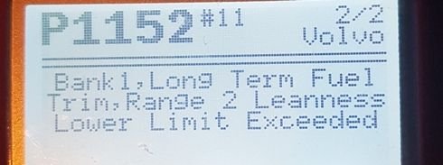

I have a screenshot of the error
Here it says that the fuel mixture is lean but what does "Bank 1" mean? does it indicate that bank 1 O2 sensor is faulty and if so where the bank 1 sensor is located?
Dan.

bank 1 and bank 2 refer to the cylinders - if you have an I5 or I6 there's only bank 1 if you have a single exhaust. If you have a V8 or a dual exhaust (ie 3 into 1 for the first 3 cylinders and 3 into 1 for the 2nd 3, bank 1 refers to the first side.)
