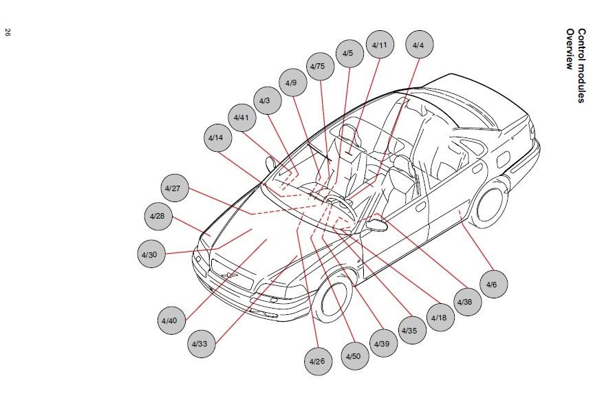

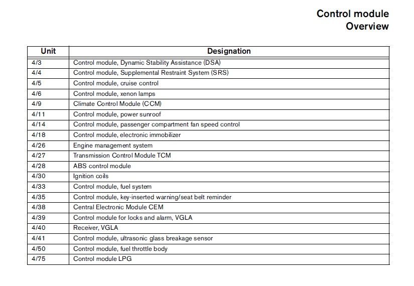

Here's a list of possible modules in an s40. Your american market car has most of these modules. But obviously not the LPG (liquid petroleum gas) module - that version was not sold in North America.
A good scan tool can talk to and retrieve self diagnostic codes from all of them. The free OBD scan from the autoparts store will probably only give you info from the engine control module. That MIGHT be enough information for you to develop a reasonable/rational diagnostic path . (Not guess, spend, replace, be pissed it's not fixed, then repeat same process again)
