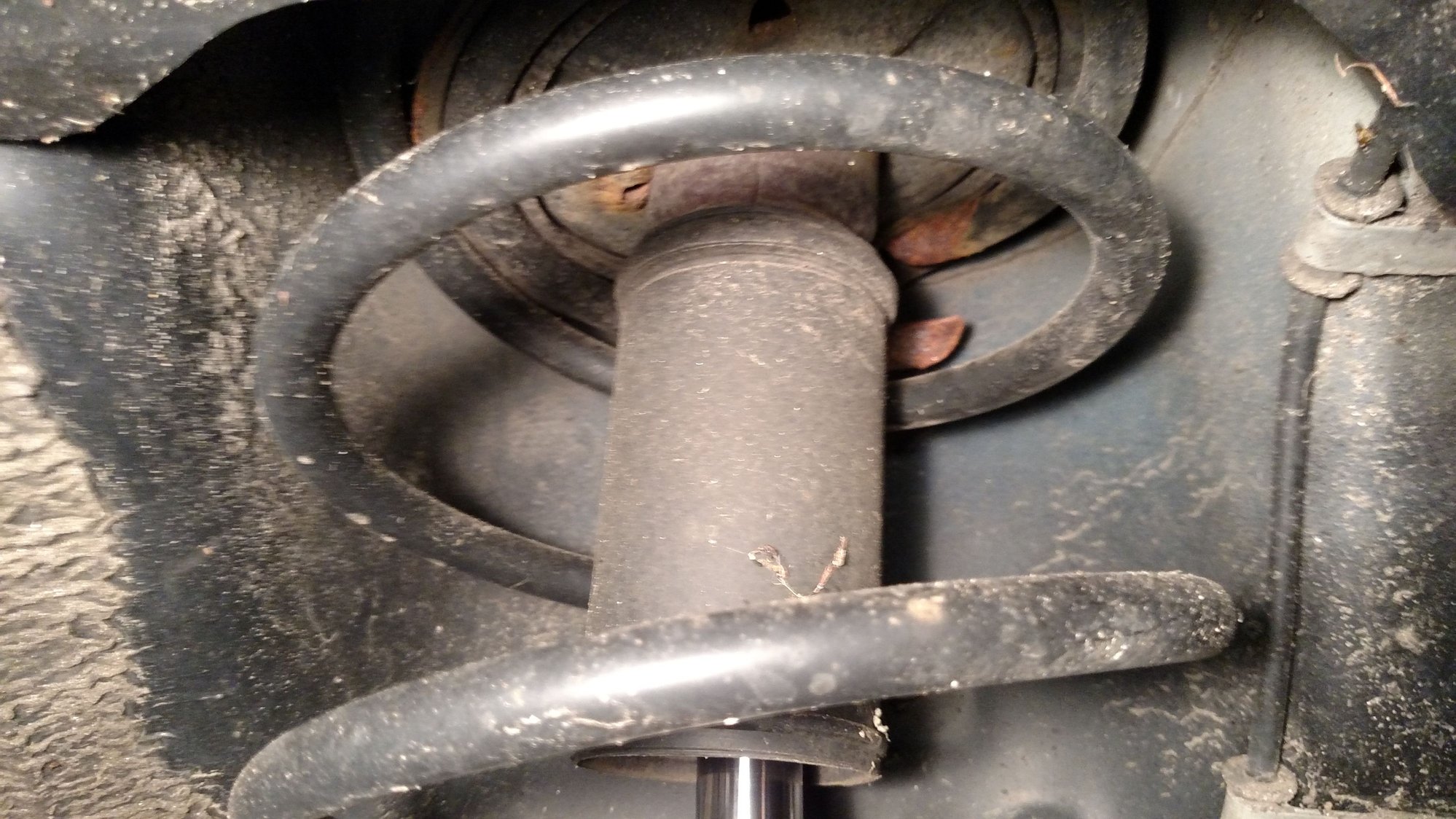

Old Jan 22, 2020 | 12:38 PM
Likes: 540
on the Gen1 S40/V40s (2000-2004 years that came to the US) have very tall, thin springs to give a moderately firm ride. The coils are almost progressive in appearance and tend to break the last 2-3 inches of coil - right where it gets worked by the spring seat. Most people won't even know the coil broke unless they look for it. I don't know if the Gen2s have the same issue - they are more common with the S60s than the Gen1s which were their own parts bin. Easy enough to inspect when you go to look at the car.
Old Jan 22, 2020 | 02:20 PM
Joe2006's Avatar
Joined: Jan 2020
Posts: 17
That does not look good! Thanks for the picture.
