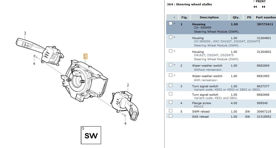

Hi all, just joined. I've got a 2007 2 litre diesel v50. The indicator is stuck on and I've been told I need to replace the stalk. Every other model it looks easy but as far as I can tell on a V50 you have to remove the steering wheel and replace both stalks as one part. I've found a video of how to remove the steering wheel but can't find anything on how the change the stalks. Anyone able to help me out with advice or links? Thanks

Looks like it's held onto the steering wheel module with 2 screws.

Nice. Looks like I can just replace the stalk then without having to take the wheel off?
