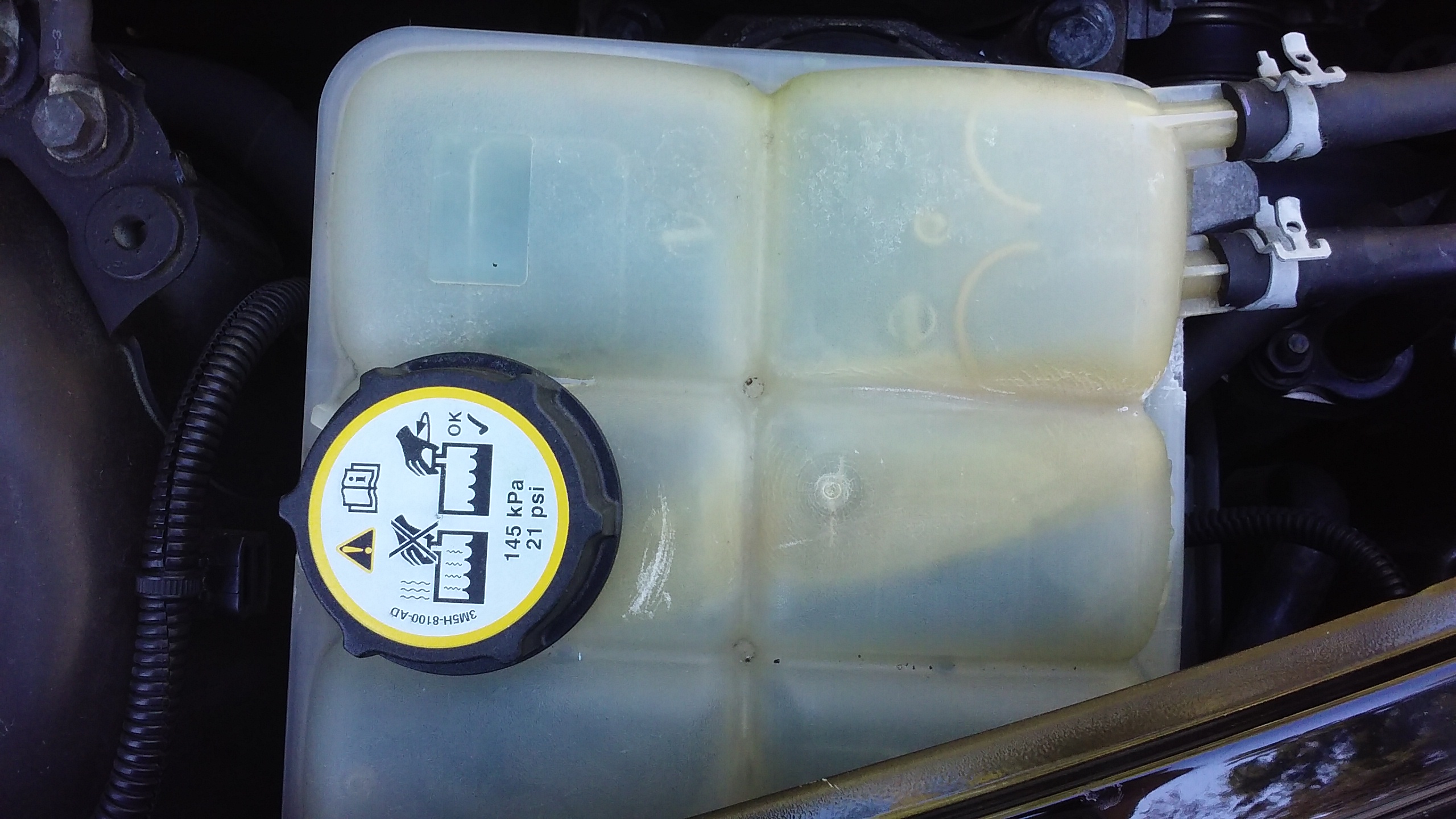

Ok I just edited and the picture taking was just done. I saw a spot that looked chipped so I took my finger nail and started chipping at the mark. The chip got bigger and bigger and to me that showed this reservoir is brittle. Now it was one of my guitar picking nails but still IMO it shouldn't have been able to be chipped.
Where it is leaking...who knows. It could be a hairline crack where the top and bottom are glued together.
Now to remove that thing is another task. I know the pwr. steering reservoir and the expansion tank on the S60 are always hard to get apart. The expansion tank on the V50 has the same locking arrangement and the rear looks even harder to get at.
Is my theory a possibility?

It usually cracks on the top, which is not in the picture.
As for removal, it just pulls up.

I filled the tank, our driveway is on a hill so it looks rather full.
Here is a picture from the top. I can't see any cracks but I haven't looked at a lot of these tanks.

Looks like its starting to crack. Looks like hairline cracking around the round spot right in the center and also under that. I would replace it.

Agree. I can see hairline cracking at different places.
