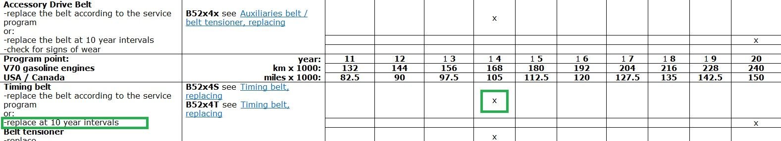

Ok, so I just checked the Timing Belt on my 2002 V70 Station Wagon (Non turbo). The belt is in excellent condition. I can't see ANY cracks, kinks or even hairline fractures. There are also no indications anywhere that I can see as to when the belt was replaced. Car has 175K on it now. Bought it in 2017 and did not put many miles on it as I mostly use my motorcycle.
The Belt is in Prestine condition. How do I know when I should change it?
One mechanic wants $700 for labor for what it seems to be 1-2 hr job. I've never changed a timing belt before but have done many other things and basically maintained my cars myself.
Thanks for the help.
It's a 2hour job for an experienced mechanic that will do it properly with the correct tool to lock the cams in place and ensure the engine won't kaboom on startup. It's longer than that for someone who has not done it before. As someone who has done a few on the volvos I owned (and has never done it in under 2 hours,) I would have no problem paying someone $700 labor to do the timing belt on my new car as long as a volvo shop is doing it. I also have never locked the cams, but I used the timing marks which is probably what I spent most of my time on locating and setting position and making sure it was still good after assembly.
With these cars, if you don't know when the belt was done, I would get it done to be safe. As others mentioned, time passed is just as important as mileage gained.
I would highly recommend a water pump at every timing belt replacement on "white" engines, except for those 850s with 50K-70K interval. I have seen too many times a water pump failure after the first belt replacement, be it 105K or 120K. It IS very likely for a water pump to fail when it has excess of 100K miles on it, and NOT likely to last 'til 210K or 240K. Likewise, use only OEM pump, either Volvo branded or Aisin. Aisin pumps are the OE Japanese pumps for these engines.
