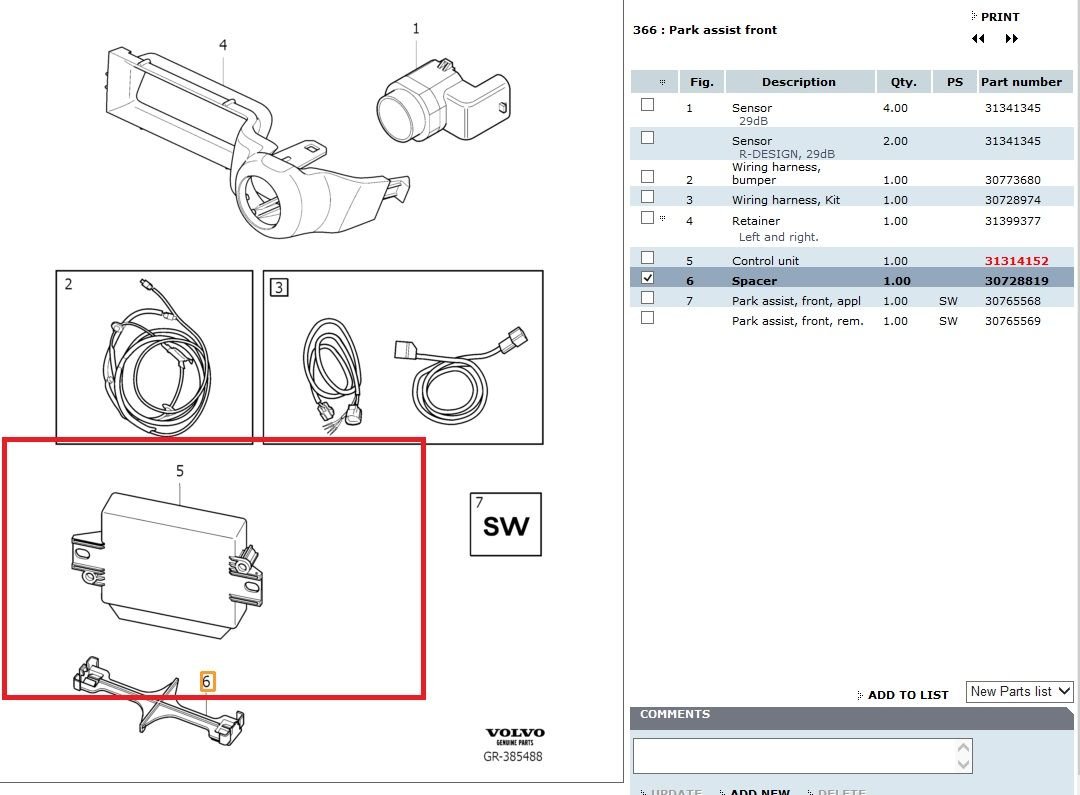

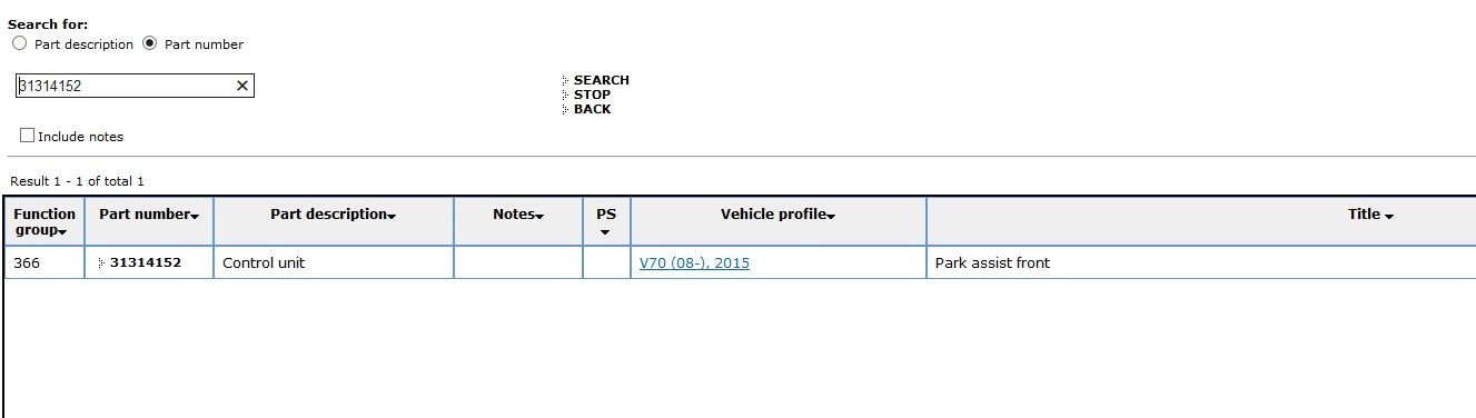

I’ve just looked in my boot and there’s a black box with 31314152 on it, on the right hand side.
is this the handbrake control module ?
Old Jan 21, 2026 | 03:10 PM
Looks like that is for the park assist - (the module you are looking for looks like it's mounted in the left rear of the car)
