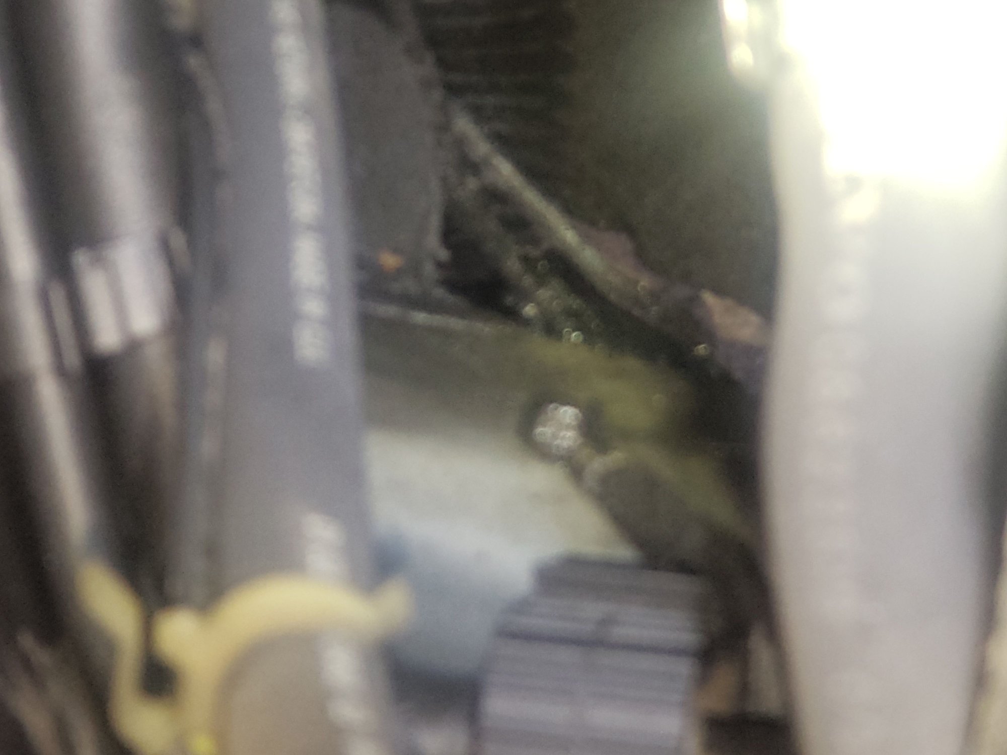

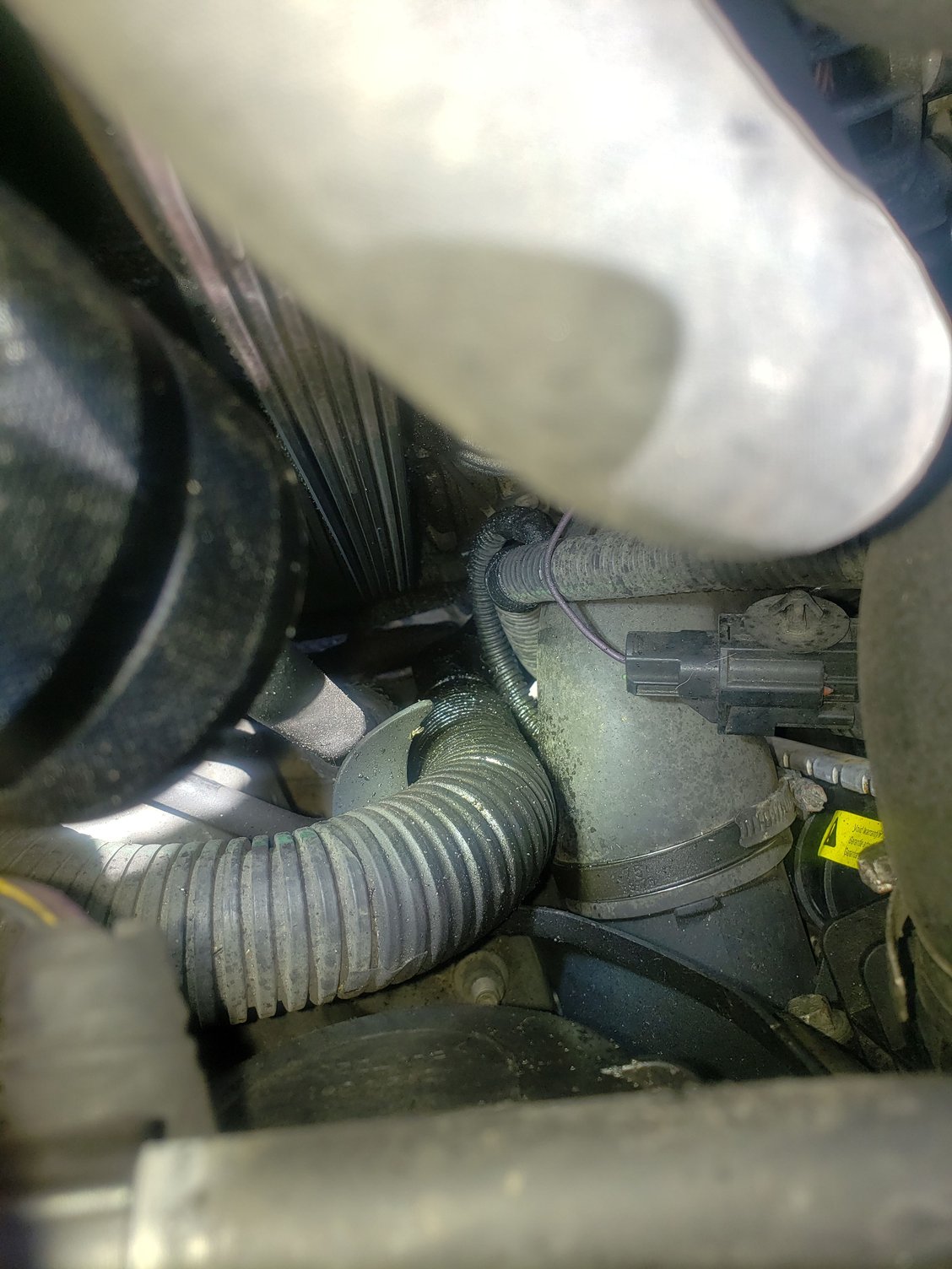

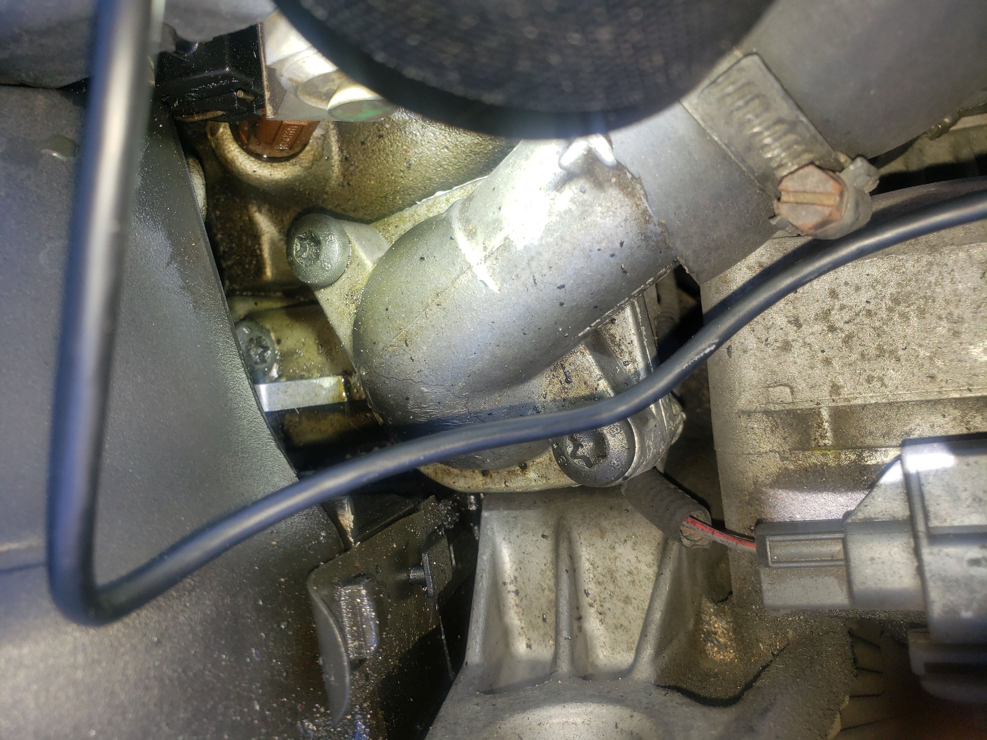

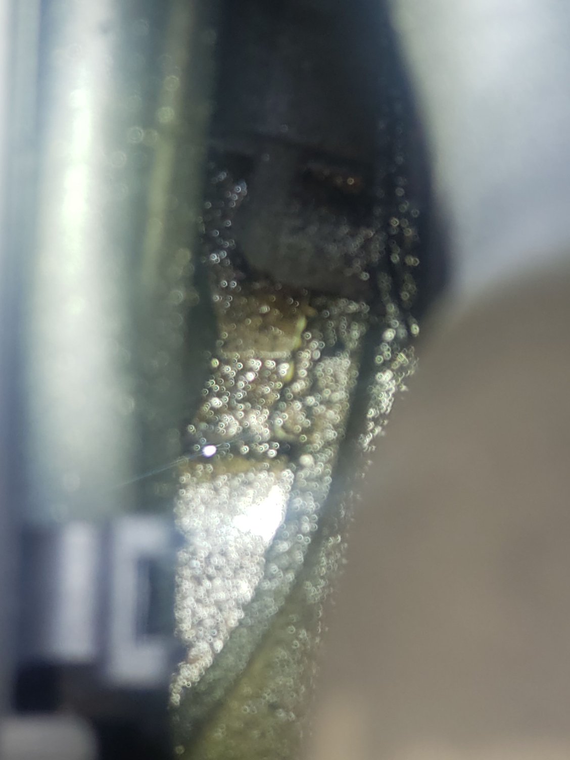

Oil leak seems pretty bad this is my 1st Volvo. It's on the passenger side only near timing cover i took pics yesterday and i also put in a bottle of stop leak and added 2 qts. It's not a fast drip leak that I can tell. I wish I had that uv dye to see exactly where it is.

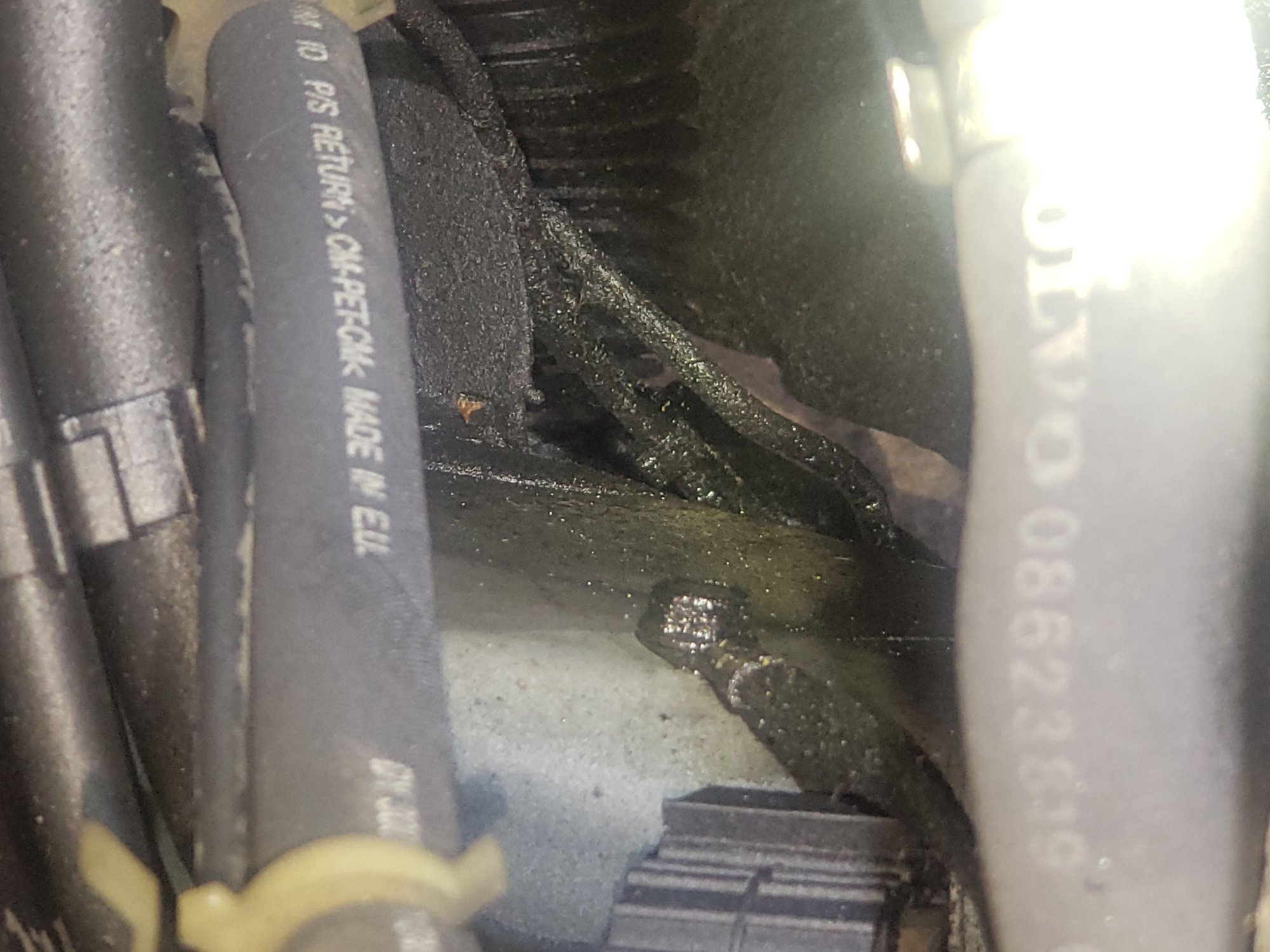

So I took off the timing cover and the cover for the coil packs. And looked down along the belt I started to clean the area the best I can i lost daylight but i seen a very slow drip like 1 drop every 2min on passenger side towards the rear passenger side of block. I'm gonna do the oil change in the morning but not before i track that leak. Because we all know this freaking price gouging monopoly were having to deal with oil isn't cheap. I don't want to put 6qts in just to see it on the ground. And since the file for my pics won't post i'll have to carry it over to a new one. Thanks again for your input.

The cam seals are occasionally known to leak on my cars (non VVT). Not sure that's what you are seeing there, but it sure could be. That was my first guess. It's not trivial to replace that, as you can see, but with the right tools it wouldn't be too hard either.
On my cars, they'll walk out, and by that I mean it uninstalls itself over the course of years. But on yours, it's a very different seal.
