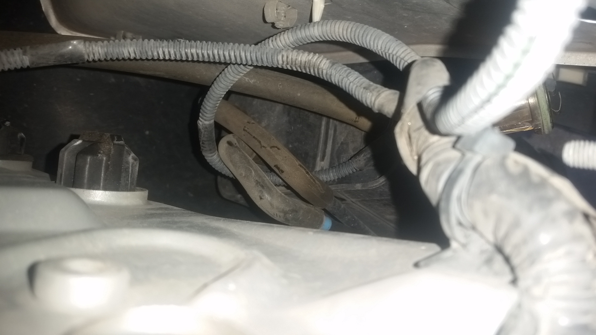

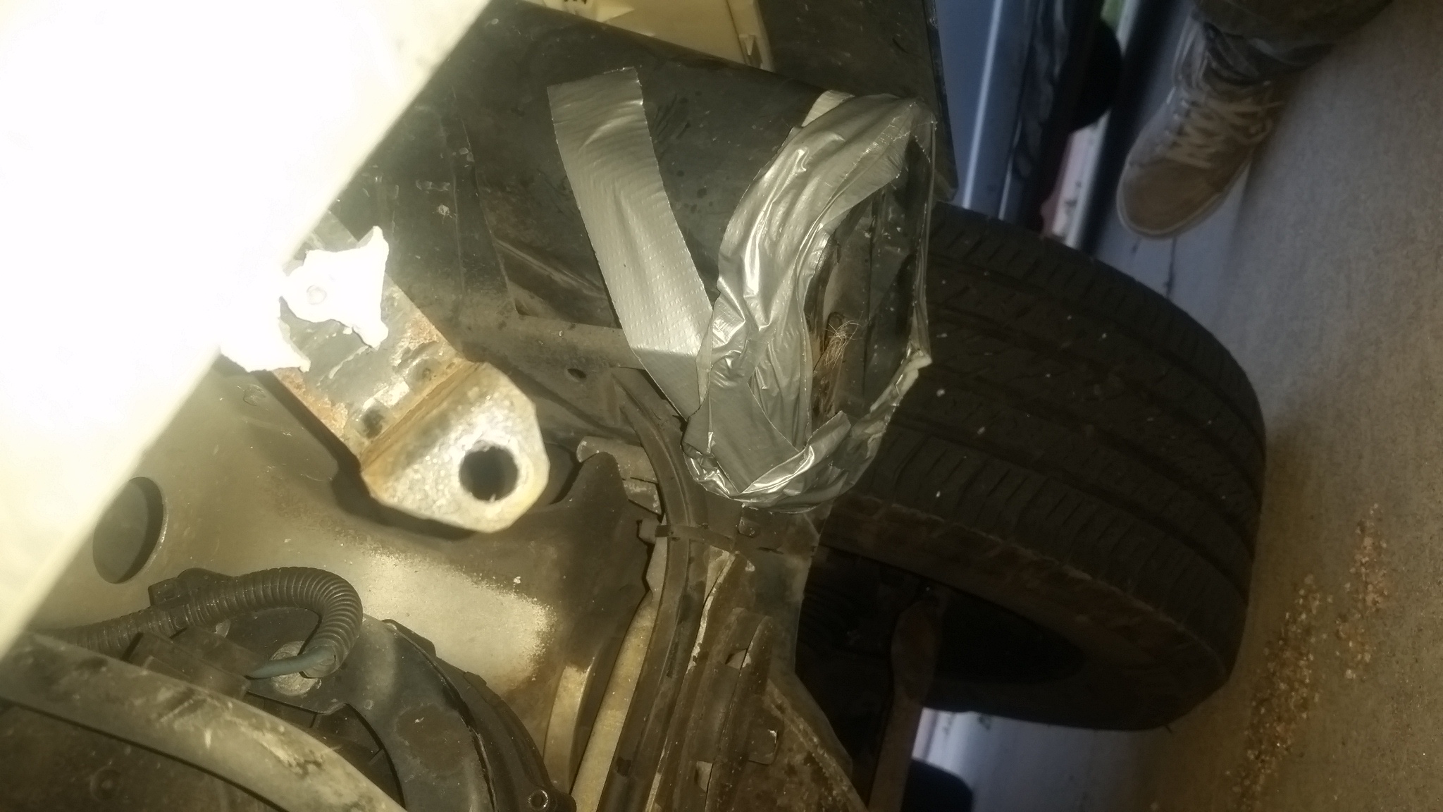

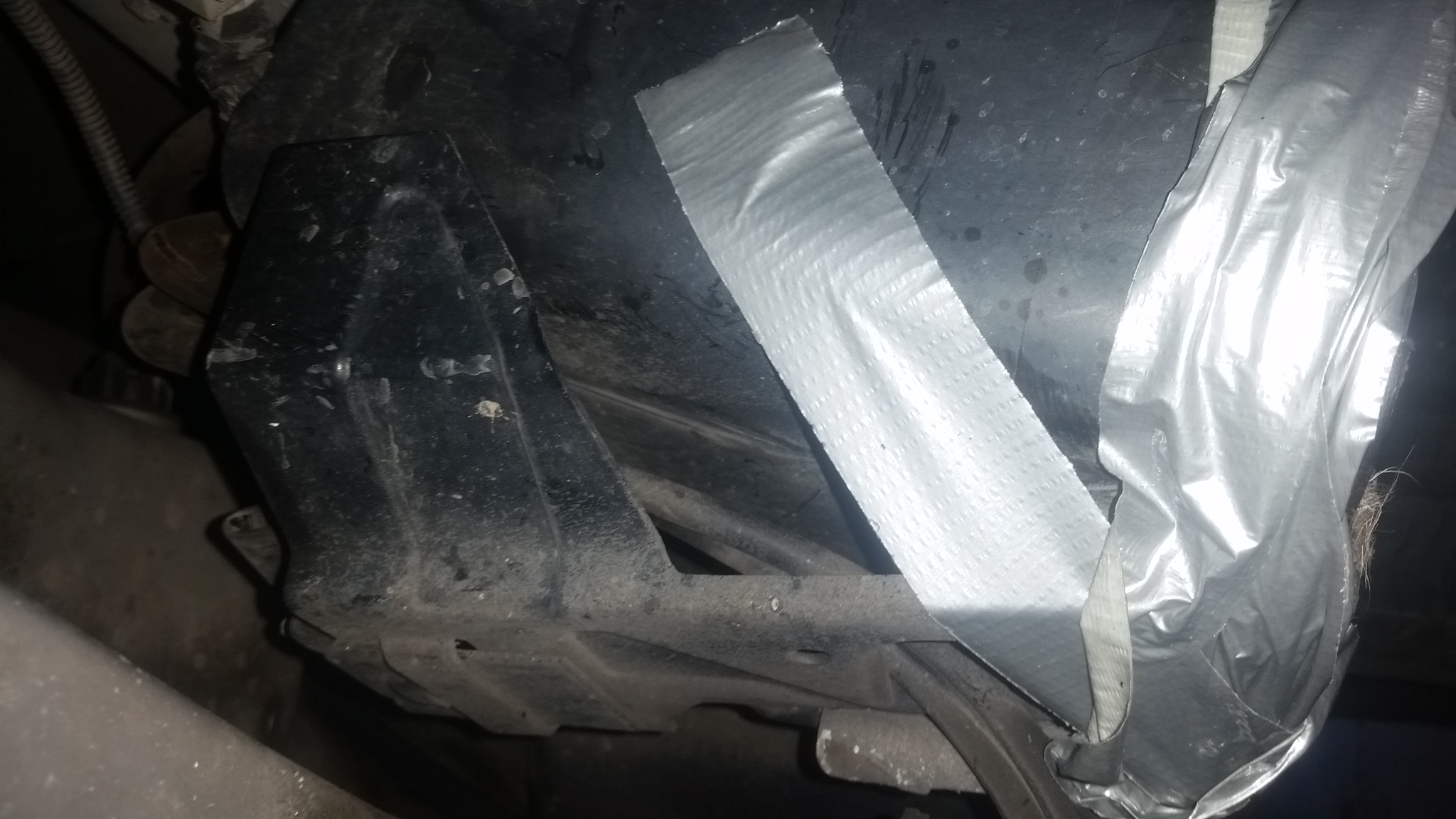

Yea these are the best pictures I could get, one through the turn signal, two from the bottom. I should clarify it's the drivers side, in front of the wheel...other thing coming to mind, is the car has what appears to be a lot of aftermarket parts on it, or at least stickers and hoses that are after market. Could it be an optional thing people commonly mounted to volvos? There's 3 tubes, two going in on one part, the one coming out from it and it's running towards the cab, almost toward where the vent by the steering wheel would be. Thanks alot in advance I'll try to get this bumper off in the mean time
That's the carbon canister. Fuel vapor sticks to the carbon. The gas tank is vented through that box. When the engine is running, there is a valve that will open and suck air in through the box, which recovers the gasoline back out of it.
Knowing that doesn't really help you, but that's what that is.
Maybe. That is part of the evaporative emissions system (where the fuel tank is vented, basically), and the car pressure checks that system periodically. It will set a check engine light if it thinks the system is leaking. It seems like that particular code would be one the autozone guys could read, but I am just making that up.
It is not going to affect drivability at all, I don't think. When the system is sucking air in, if it sucks too much in, then you might notice that. I don't think that will necessarily happen.
