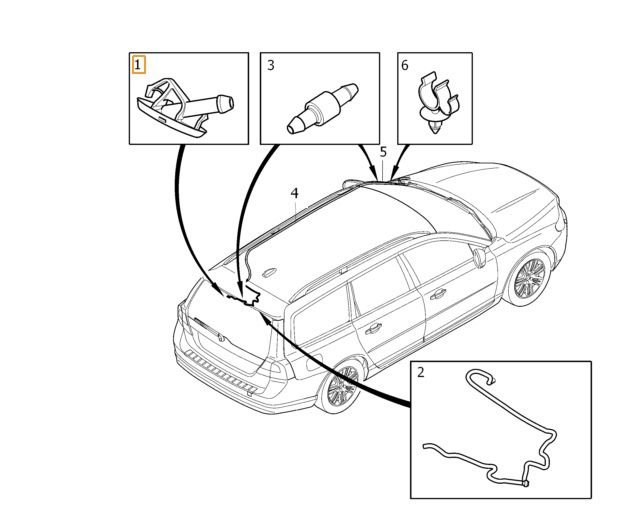

​​​​​​No fluid goes to the rear windshield, instead I hear water flushing around the dashboard, front pillars and the floor on the driver's side gets wet.
​​​​​​The car is a 2011 wagon, left hand drive.
Has Anyone encountered this problem before?
Has someone the diagram which describes the route from the reservoir to the rear windshield?

Parts catalog shows it going up the a pillar -

Thank you Hoonk, thanks to you I Will not tear apart my Volvo Carpet.
Do you know how hard it is to dismantle the trim ?
According to the diagram, I believe the leakage occurs at 5, where the hose is probably disconnected.
