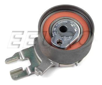

Thanks. I'm not sure something bent it, but rather someone bent it installing it incorrectly. That said, I am getting conflicting responses from various Volvo sources that say that the tensioner on my car is the incorrect tensioner. That the correct tensioner is Part #30637955 or the attached image. However after inputting my cars info into FCP or other similar sites I get timing kits that have the currently installed Tensioner on my car in that kit, so I am confused.
In any event, is it possible to re-tension the tensioner properly? I am moving shortly and need the car to move from point A, to B. So if it is possible to have the tensioner tensioned correctly prior, that would be great. I am purchasing a whole timing kit, but if it is possible to give the belt a bit of slack and allow the tensioner to work as intended until then, that would be fantastic. Thanks for your help.

Any sources that say your tensioner is not the correct one are bad sources. That is the correct tensioner. But it is indeed damaged and should be replaced.
