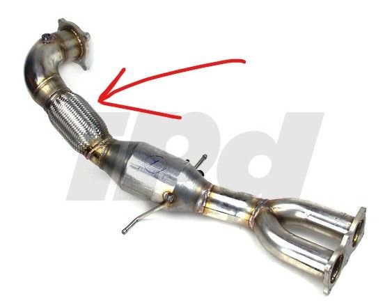

My experience is there's three more common causes for exhaust leaks 1) leaking flex pipe. Over time the metal in the flex pipe mesh fatigues and creates the leak. Usually you need the engine running with the car on the lift to hear/feel the little puffs come out 2) broken EGR tube. Not sure if this is still a thing on a 2016 (sorry showing my age) but the EGR tube attaches to the downpipe to suck exhaust gases back into the intake for emissions. That tube can crack/break off creating a leak 3) broken header stud or cracked manifold. Not sure how common this is but you should inspect as well. I suppose its possible there could also be a gasket or turbocharger issue (say a cracked housing/blown seal etc)
Note that the flex pipe is part of the front cat so while its easy to replace, the OEM part is going to be expensive. You can buy replacement aftermarket flex pipes but that will require cutting/welding etc to fit into the front pipe.

Thanks for the reply and ideas. What is "Note that the flex pipe is part of the front cat"

mt6127 is referring to this flex pipe and is letting you know it comes as part of this whole pipe which includes the catalytic converter (big $$$) (This image is not an OE part but gets the message across)

Default Question about Photo and Actual Part
Good morning, I was poking around the internet using your photo (Dingus1) and found the various prices and how to ensure the part will fit my XC 60.
This morning on ramps I took photos and realized my exhaust is different than what I am seeing on the internet. My catalytic converter is on the top of the system and the flex pipe is below the catalytic converter.
The leak seems to be coming from the top of the catalytic converter, of course where you cannot see it.
