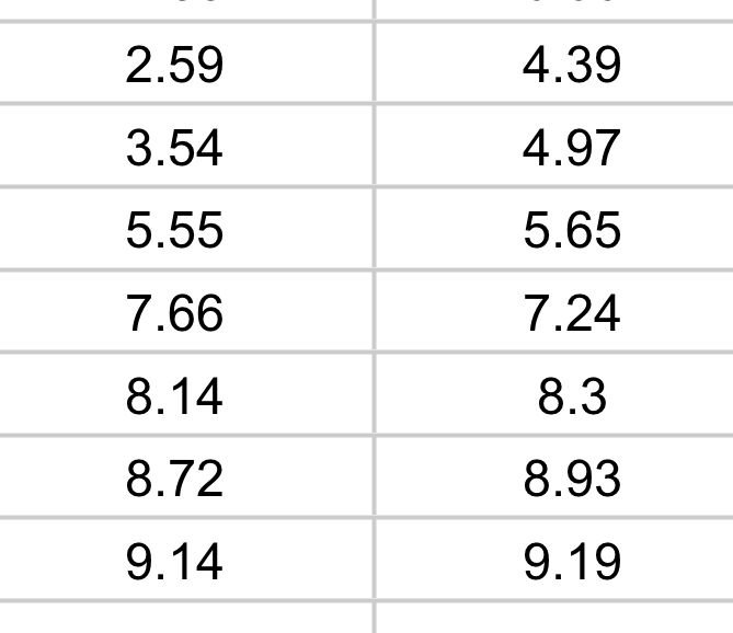

I have some solid numbers now. I used a OBD reader to record the gas level. And it has “DIM fuel level 1 of 2” and “DIM fuel level 2 of 2”. Looks like they are from the two side fuel level sensors. When my XC60 fuel gauge change from 4 bar to 3 bar, one side shows 2.59 gallon and the other side is 4.39 gallon.
I attached the numbers I got from different dates and hopefully it is helpful.
For my car, every time the 4 bar gas gauge dropped to 3 bar, I have 2.5 gallons available. That would give me around 40 miles to go. To be safe, this is the moment I fill up the car.
That’s what I have for now and hopefully it helps.
