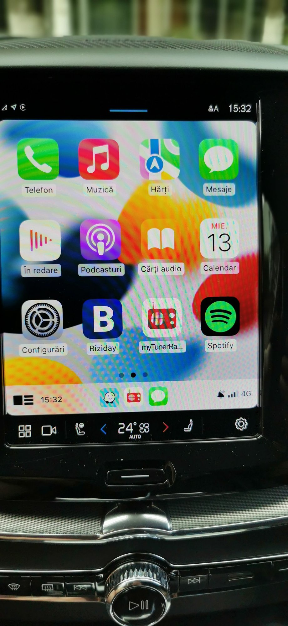

I've made the update today. Full screen apple carplay. Working beautifully 👍
In Europe working fine
Full screen carplay xc 60 B5 2022
