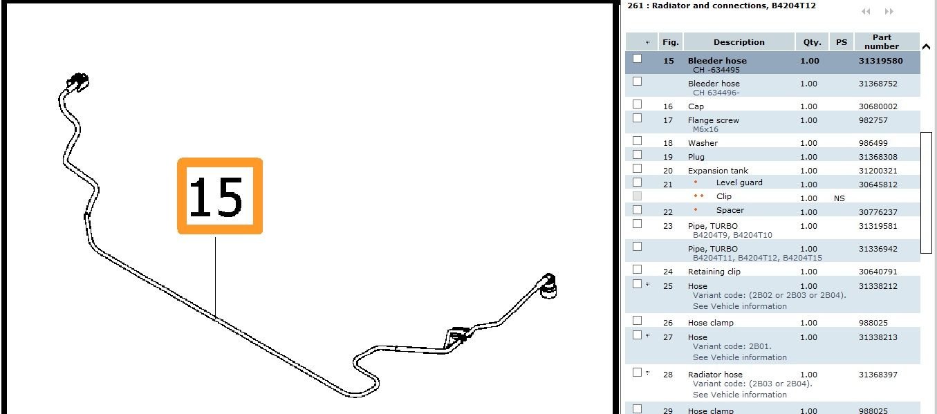

The black plastic pipe looks like the air bleeder hose that connects to the top of the coolant reservoir. The brown plastic part might be a 31338581

Many thanks. The part 31338581 does look visually near identical.
The part is only $40 online. I am tempted to buy it and try replacing it myself
Again, many many thanks for this lead

Thanks, will send VIN with order. With a little more research (based on your info), I am now 99.9% certain that this is the right part
