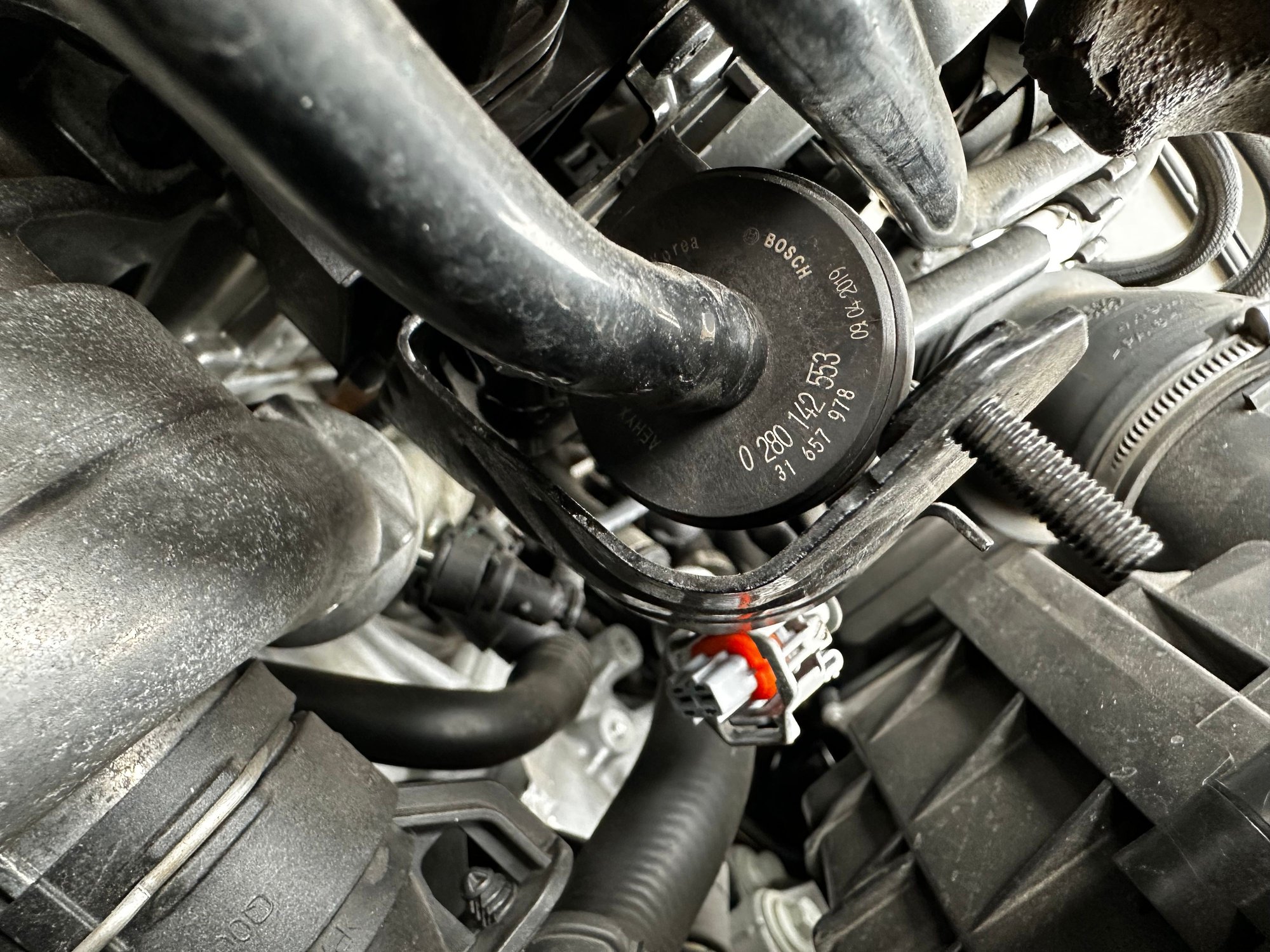

Forum Newbie. I’ve got the same issue, including struggling refill restart. Car runs sweet despite fault code for nearly 12 months now.
Several service centers have given me different options in that time - including Bosch service centre.
Disconnect the in line sensor / component pictured and the fault will clear and not return until the engine is switched off
Disconnecting as pictured and the fault will stay cleared whilst car is running.
Does that suggest its that component at fault?
Anyway, Feels like it’s just going to have to go back to Volvo Service 💰 😫
welcome any thoughts
