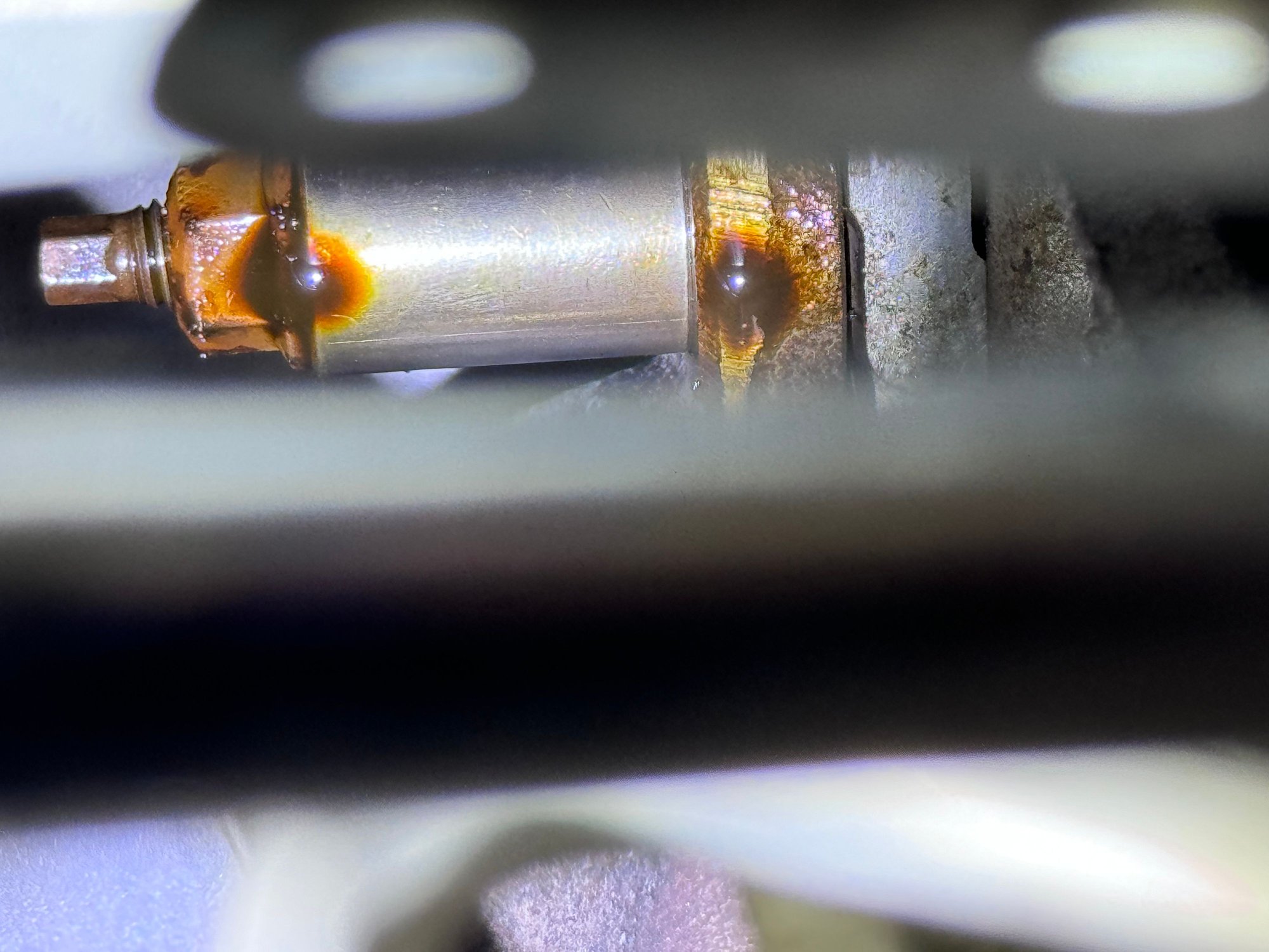

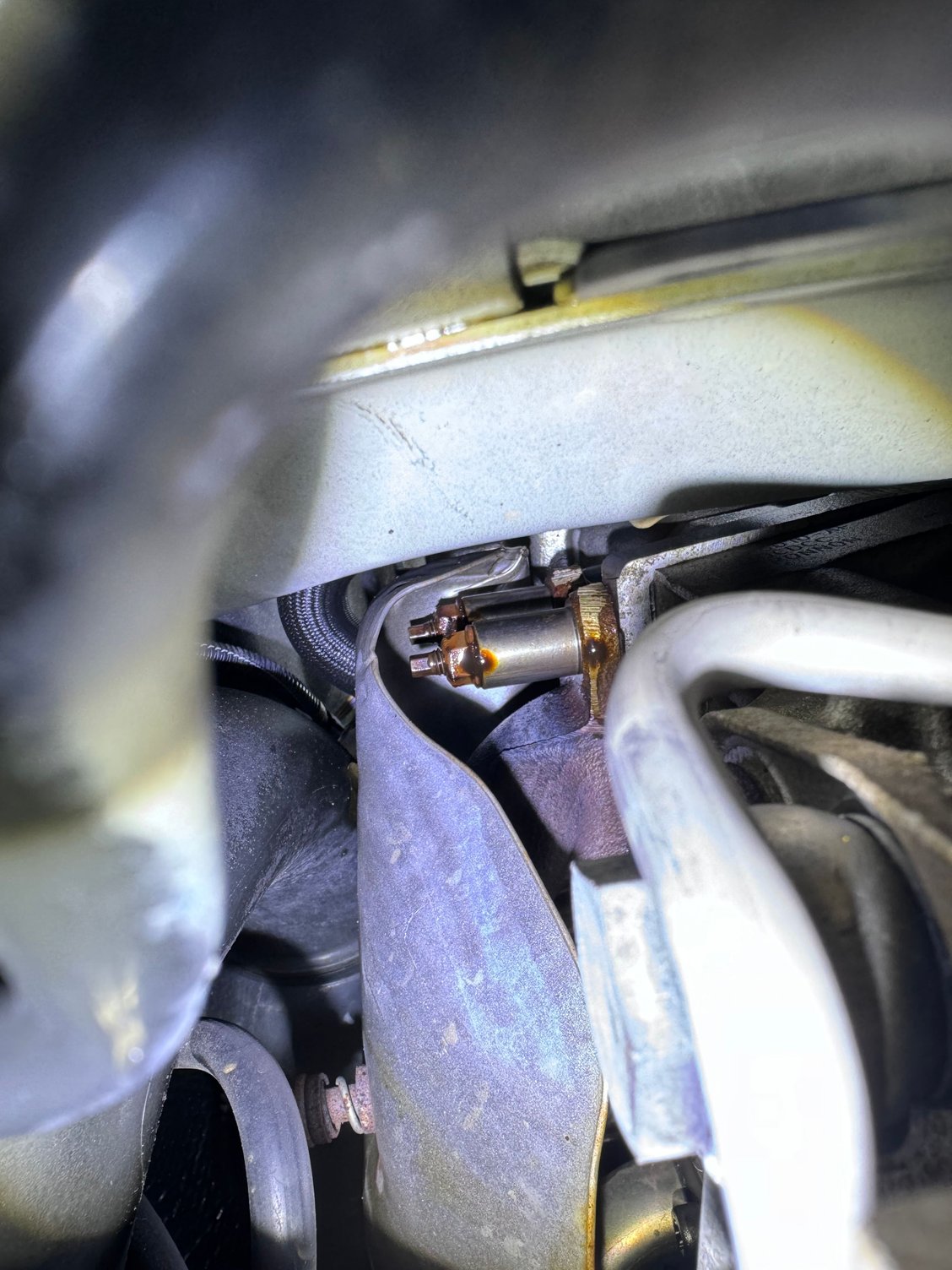

Can anyone help me. My 2010 Volvo xc 60 started leaking oil and I took a picture of the area it’s coming from but I have no idea what I’m looking at.

best thing to do is to clean off as much of the engine as you can then after a drive, see if you can find the source starting top down. Most common areas are cam seals (front and rear), turbo oil line seals and the oil filter/housing. Less common are main seals and head gaskets. Only other thing to check out is the PCV system as that may cause an oil leak as well, either by having a tear/loose fitting in the tubing or by creating positive crankcase pressure which can blow oil out of the cam and main seals.
