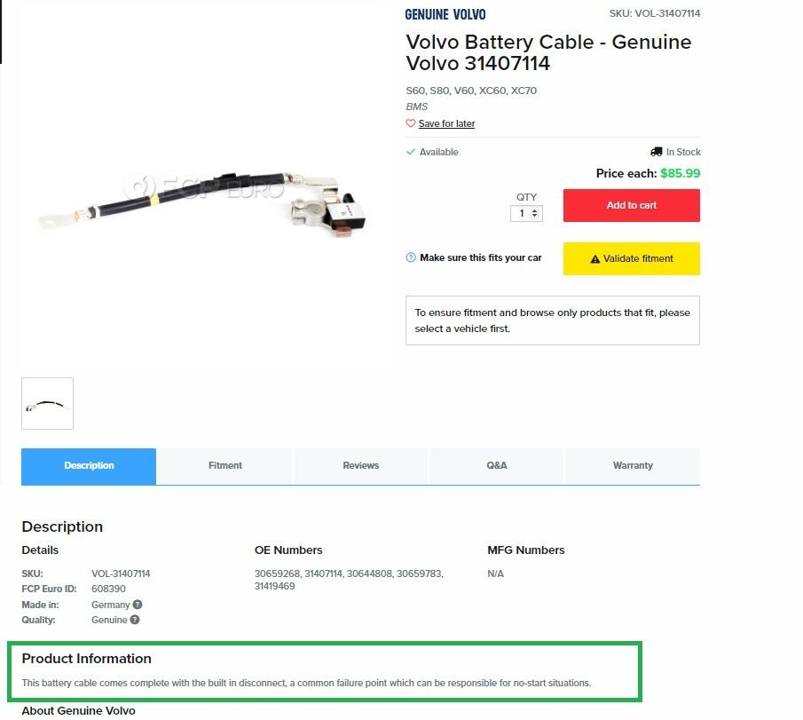

Old Jan 19, 2024 | 04:40 PM
On the battery terminals - there are "fuses". If mistreated they can crack/break and cause problems such as yours.
Do not order the part below - it is just representative and there are many choices depending on your specific car.
